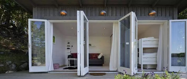

Google translated Swedish webpage with materials list for a “Friggebod” 15m^2 Despite what the eminent SketchUp sages post, metric is SO much better, it is good to use as often as possible.
