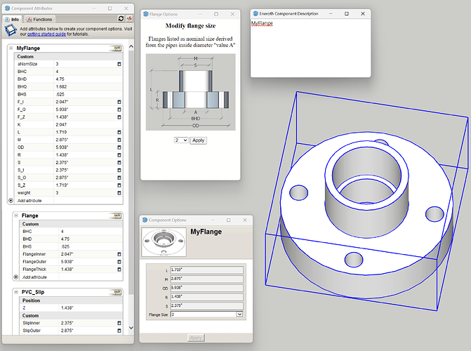

Thank you Dan, I am trying to learn, this is exciting to me. I am working on a dynamic component that I was trying to control and display data, much like the attribute pop up, but with more detail and control in both directions. Eneroth3 has a unique way of targeting the component. I was able to control the component from an html dialog, but next trying to get the dialog to read from the current state of the component. Here work looks promising. :
On my Flange Options dialog I am hoping to get the current state of the dimension callouts that are shown in the Options pop up. Then I would not need both pop up and dialog open. I apologize, I did not intend to hijack your post Eneroth. your extension is very clever work. Nicely done.

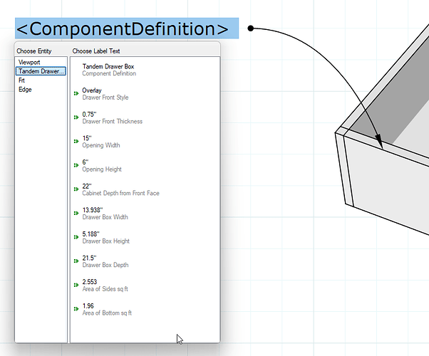

You can get a lot of that information in Labels in LayOut. Hereās an example from aDC I built for a client. This is all of the atributes for the drawer box component.

Currently, (I think) the exposure of definitions in LayOut are hardcoded and limited to the "dynamic_attributes", āSU_InstanceSetā, āSU_DefinitionSetā and IFC dictionaries.
I asked for a way to specify the name of the dictionary and attribute: <dictionary["name"]> or similar.
