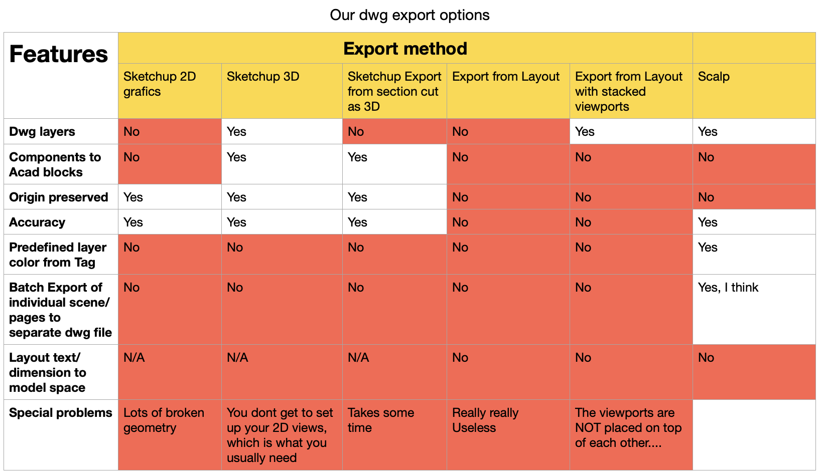

I’m sorry TIG, but I disagree! The AutoCAD 2D (hiddenline) export doesn’t use the SketchUp layers but the Skalp 2D export place every line on the correct SketchUp layer.
SketchUp export:
Skalp export:
Only layer of the windows visible:
That is very cool! I think TIG was saying that Skalp is the solution for the original issue.

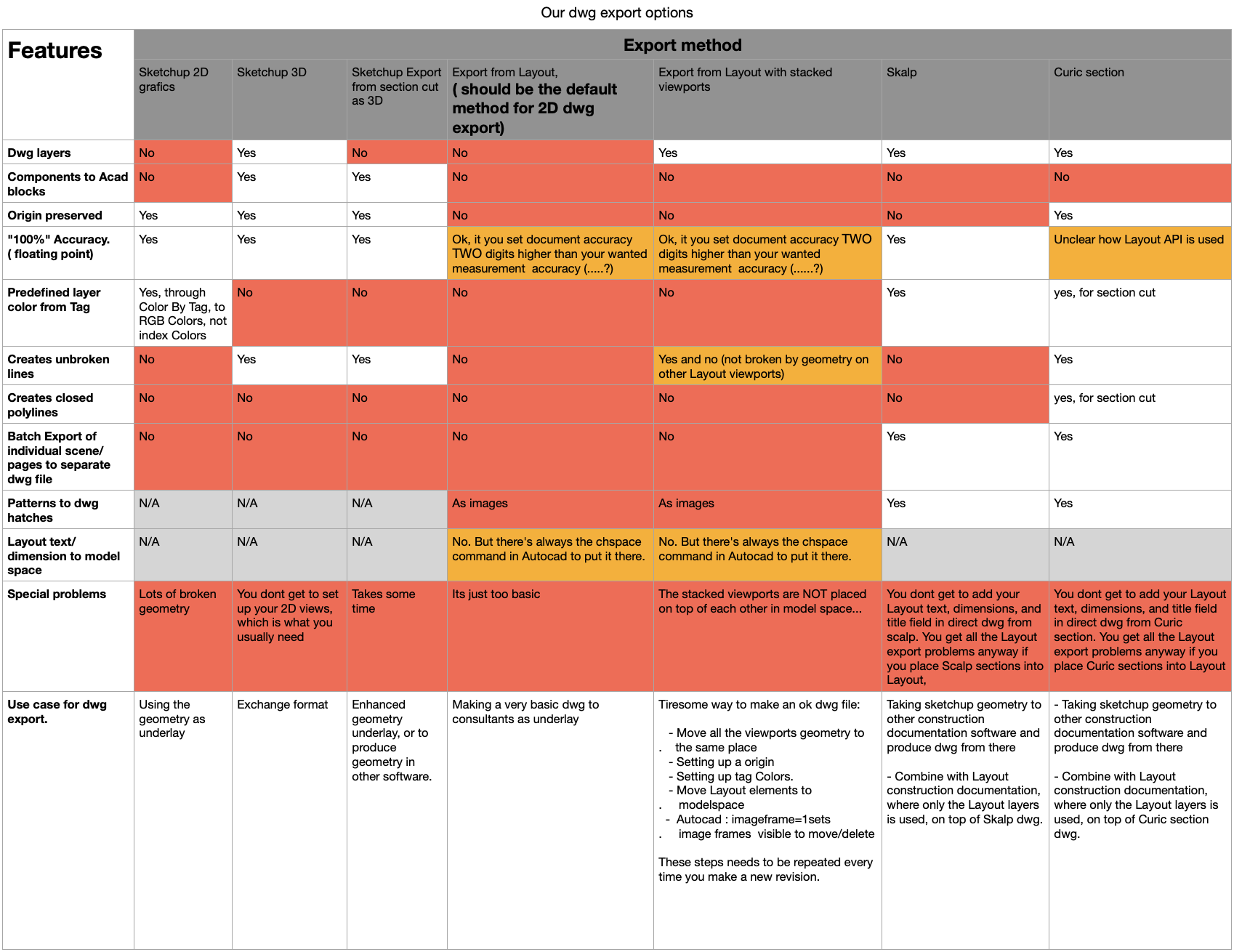

Thanks! As of late, I’ve been outputting backgrounds for consultants from layout. Cleaner DWG look, retains wall cuts as a layer, but all of it is just lose geometry if someone needs to make a change.

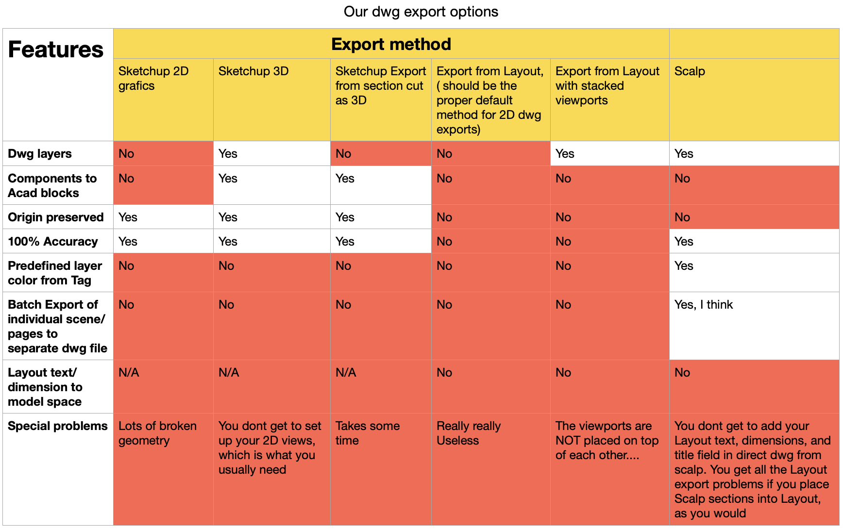

Good matrix. I’m not sure I follow on Accuracy-No for export from Layout. I can’t say I’m having problems with the accuracy.

Some revisions to my matrix attached. Scalp exports are not that useful, as they dont include your Layout dimensioning and text.
Hi Odd_Haakon_Byberg, you may need to edit a little bit at:
- “SketchUp 2D Graphic” Method.
You can keep color from tag when export if using “Color by Tag” mode and change color of egdes to: by material in Edges settings.
But:
- Still same in a layer, but after that we could use a lisp in AutoCad to automatically assign objects to seperate layers by color.
- Color for these layer in rgb, so we can’t use ctb plot style to print the file.
- Curic Section plugin (same funstion as Skalp) can export to DXF maintain Layers and create close polylines and hatches for sections.
You can fill out to Curic Section column follow:
- Components to Acad Blocks > No
- Origin preserverd > Yes (same as SketchUp origin)
- 100% Accuracy > No, but 99,999% (he said he use LayOut API for export)
- Predifined layer color from Tag > Yes, but not all. Just be cutted by section plane.
- Batch Export > Yes with Curic Scene Manager
- Convert hatch from Section hatch to Autocad hatch > Yes
- Convert each section boundary to closed polylines > Yes
