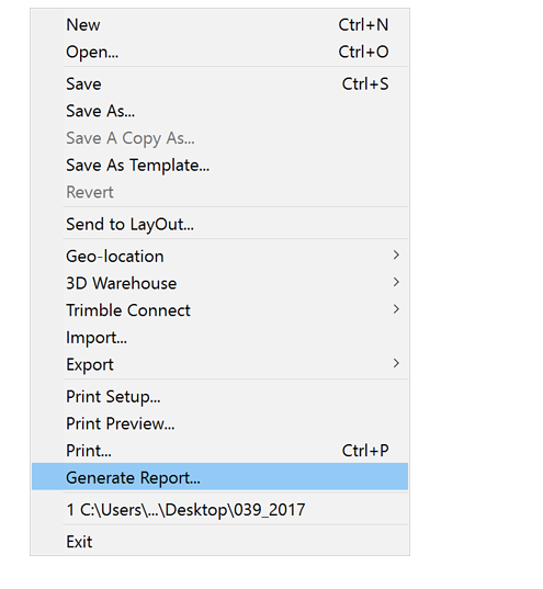

OK. From that menu screen shot you must be using the trial version of SketchUp Pro not SketchUp Free. Or did you get that image from someplace else?
To import a JPG, use File>Import. (Right under Trimble Connect)

No do not have trial version it is web based free version. I got the screenshot off the youtube as I tried to find how to import the image from youtube! and the drop down menu was there thus my confusion as to why I do not have it. However thanks will try your method and I am most obliged to you.

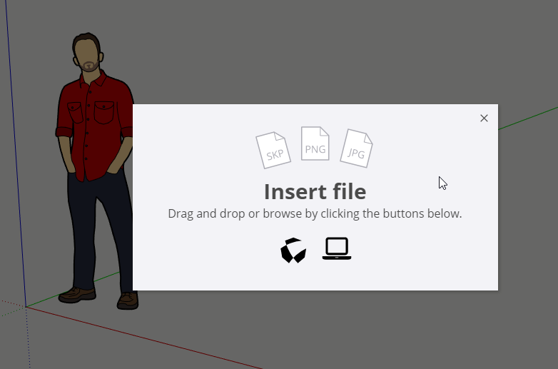

You’re using a different version from what the author of the YouTube video was using.
SketchUp Free, the browser-based version does not have that menu. Instead, click on the file folder icon and choose Insert.

The SketchUp team decided to create a new highly unconventional UI, for no apparent reason. There is no File menu! No Edit menu or View menu either.
The version with the full UI can still be downloaded here: Download All | SketchUp
