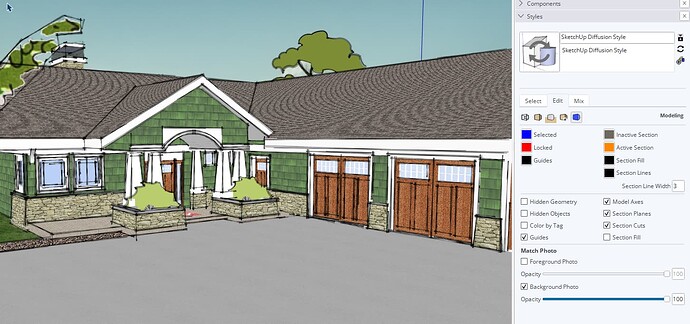

You can turn off Foreground Photo in the Style’s Match Photo settings so that the image from Diffusion doesn’t override the applied textures.
With Foreground on.
With Foreground off.
Don’t forget to update the style.

If you want to show only the materials on the model, turn off the Foreground image in the Match Photo settings in the style. I showed this in my post prior to yours.
