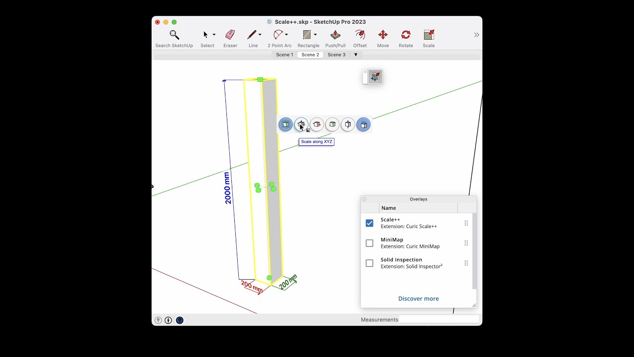

Hello everyone! I have just released a new plugin called Curic Scale++, which I want to share with you.
With the new Overlay feature on SketchUp 2023, plugins can now do many amazing things while you are using the native SketchUp tool. And I have developed a version to support the Scale Tool called Scale++ (these features may not be new, but thanks to Overlay, it brings a better user experience than ever before).
You can see how to use it in this video:
  • The Control Handles feature allows users to control the display of handle points of Scale Tool, making resizing easier and more accurate. If an object has one edge that is too small compared to the other two edges, selecting the handle point will be difficult and annoying. This feature solves this problem quickly.
  • The Show Dimensions feature displays the object’s size while resizing with the Scale tool. You can even interact directly with dimensions by clicking on the dimension and entering the exact size (this is a wonderful thing that Overlays can do), making editing more accessible and faster than ever. This helps users adjust the size of the object more accurately and conveniently.
  • The plugin also has a Referenced Dimensions feature, which helps reference and suggests the size of other object variations in a model. You can also save dimensions, Favorite Dimensions, to store commonly used object sizes, saving design time and ensuring the accuracy of dimensions.
  • All features and commands are placed into Pet Toolbar - a unique toolbar integrated into the plugin. It appears at the right time and right place when users activate the Scale tool and will follow the mouse cursor (like a Pet)

Looks promising! Some comments:
The dimensions don’t update if you do click-drag-release, it requires click-release-move-click-release.
The buttons are not enabled when scaling raw geometry.
Clicking the dimensions toggle relocated the tools. Pretty soon the tools are off screen.
I didn’t yet figure out how to add Favorite dimensions.
Once enabled, the toggle button remains active. Clicking it should toggle whether it’s active or not.

Hi @colin, thank you for taking the time to experience Scale++ and for your valuable feedback. Regarding your comments, I would like to respond as follows:
  • “click-drag-release” I believe you are using a Mac, this is a bug with Overlay, and I have reported it since the Beta version to the SketchUp Team.
  • “The buttons are not enabled when scaling raw geometry” unfortunately, you can only control the handle points of an object (group/component). The tip is to make a group before using Scale.
  • “Favorite dimensions” are the dimensions you edited by clicking on a dimension and entering before. Maybe I will add a feature that allows users to save dimensions with a dialog. What do you think?
  • Regarding the “Checked/Unchecked” status of the icon on the toolbar on a Mac, it has existed for a long time; it does not respond immediately after each click. I think this is a UI bug in SketchUp.
