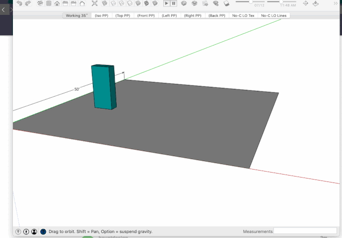

Do you use Copy/move? You can copy/move one instance a given direction and distance, then type a number and the letter “x” to make that many copies in a row. Select the object, invoke the move tool, hit modifier key control on PC I think, move your object and you will see a copy of it being moved, click to set it next to the previous, then type 6x or 22x. I don’t want to over-explain something you already know but if you’re not familiar with this then it might help.
yes i have been copying and using the move tool to do this. I still trying to figure out how to do what you said, I can use what you said to make the work faster. I could buy plug in but with just buying sketchup i want to learn to use it without any plugins first.
Don’t copy or paste. Move/Copy is a modified use of the move tool. First select an object then choose the move tool, then hit the modifier key (on mac it’s option but on PC I believe it’s Control.) you should see a small plus appear next to the move tool then grab your object and move a copy next to the original. place it by clicking, then let go of the mouse and type x and then a number to tell sketchup you want that many copies moved the same distance each time. You can continue to change the number of copies by retyping a new number until you click els-where.

Thank You it took me a few tries to get it to work. Have a great night
