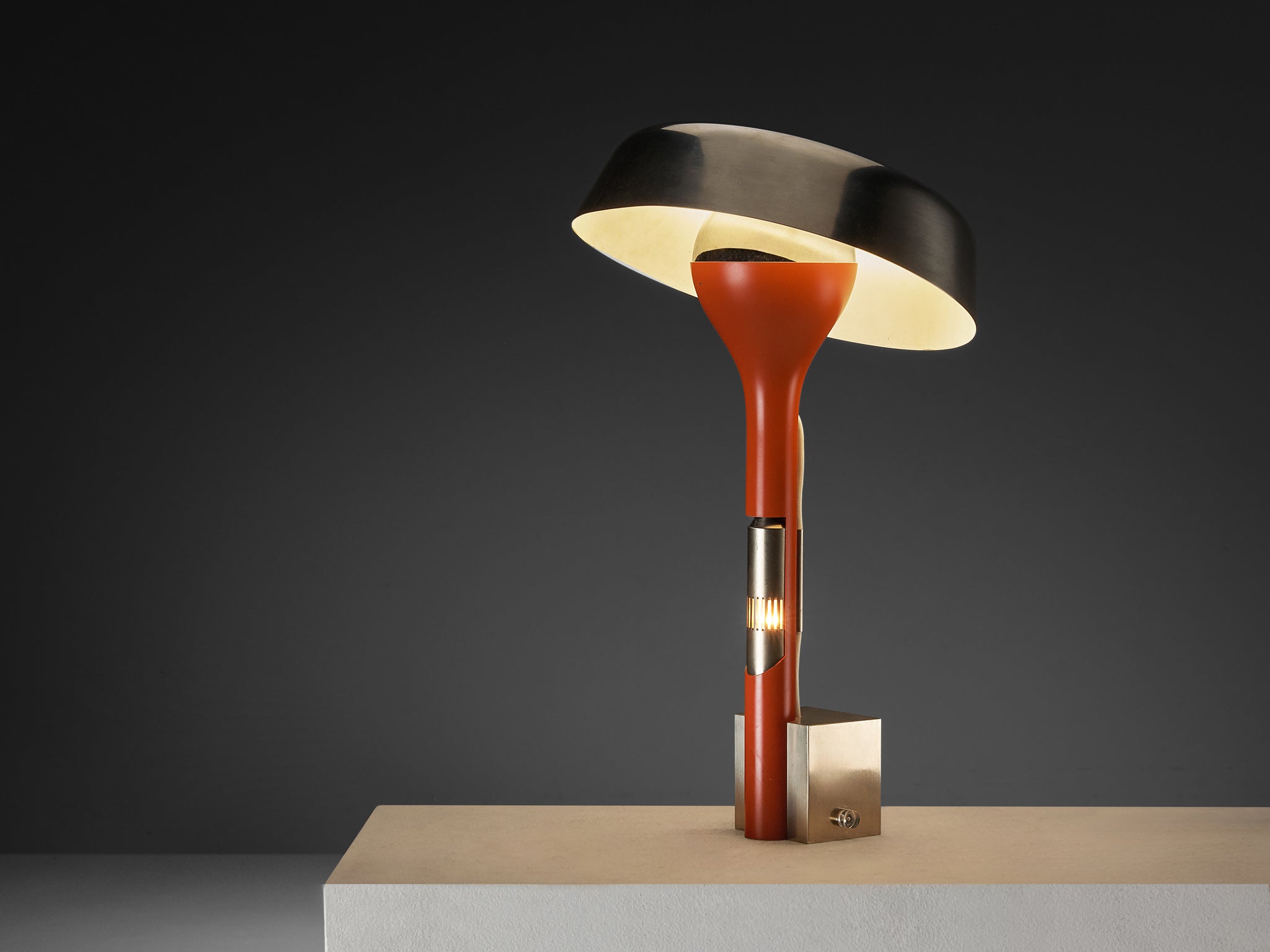

Could someone help to make this 3D model?
Hi all!
Would like to seek for help to make this table lamp 3D model, many thanks about this.
Learn about Follow Me tool at Campus - learn.sketchup.com or YouTube.
Just as an idea

Thank you so much for the tutorial! It helps a lot
But I am struggling on substract action, would you mind to explain a bit more how to do this?
Also may I know how to make the ball divided into 2 parts? (Bulb and red color)
YouTube search ‘Solid Tools SketchUp’
Change the edges from smooth to solid.
Start with the basics of SketchUp at learn.sketchup.com and YouTube SketchUp.
Thanks! It works well.
Not perfect model but built successfully.
