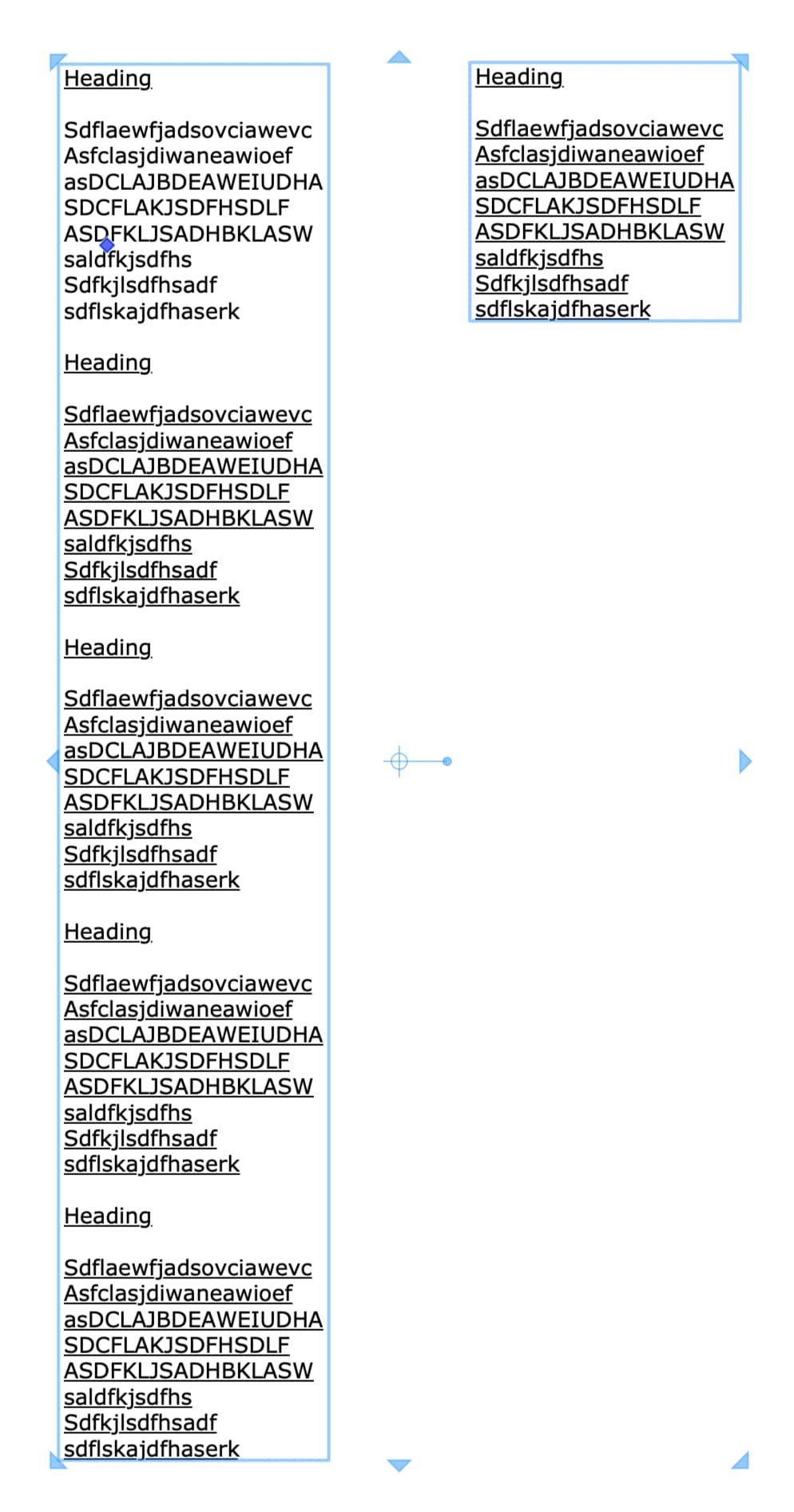

When copying text from an existing text box into a new text box, if some of the text is underlined in the existing box, when pasting into the nex box all text is converted to underlined text.
Would love to know if there is a fix or work around for this issue.

Looks like it actually performs the same way if I copy/paste text within the same text box as well. The only area this is a pain is when I create my general notes with lots of text/underlined headings. Its just a silly problem that has always existed within layout, would be nice to see it fixed.
This doesn’t work with this scenario. If the entire box was underlined and I wanted it to not be then it would work. But what I am after is maintaining partial underlines under headings etc.
That’s so weird. If you’d like to share the file, that could help with a possible fix.
I just created a brand new file with those two text boxes.
If you create a text box, underline one line, then highlight all text and copy/paste, does yours do it correctly or does it convert everything to underlined?

Indeed the copied text is assuming the characteristics of the first copied character. Tried underlined, coloured, different font, didn’t matter what it was it copied the formatting everytime and transferred to the entire copied text.
Sorry for the slow reply. I tried it a few different times with expected results before replicating what you are experiencing. Yes, when double click the text box, select all of the text within a text box, and then copy/paste it does underline everything (my first line was also in bold and ditto on that).
What has worked for me (and my usual way of duplicating columns with formatting) is to select the text box and either Option-Move to duplicate the text box or Copy/Paste. Both create a duplicate of the text box without the janky formatting. I use this method for columns of text such as specifications because I have them formatted with tabs/ indents and they are numbered.
