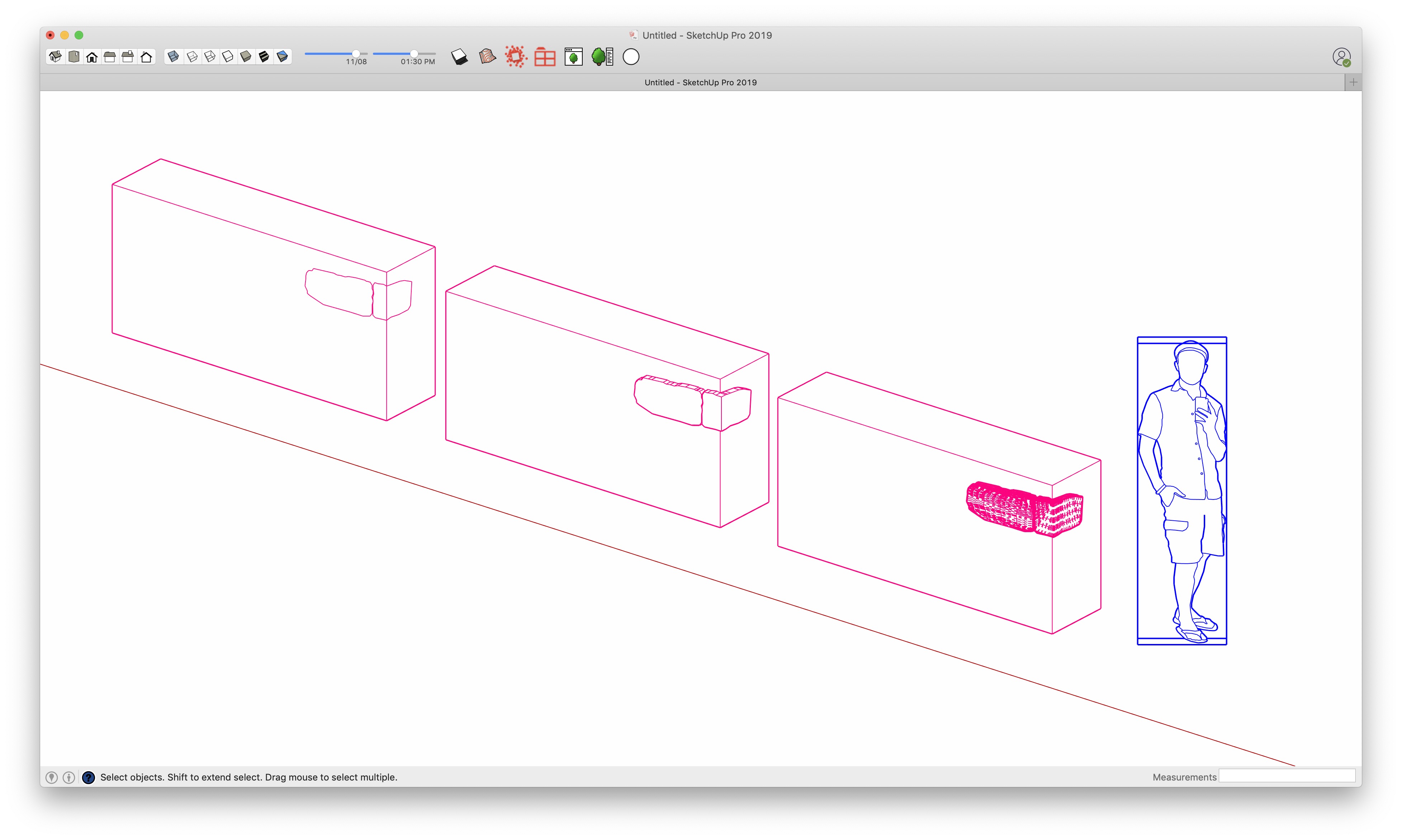

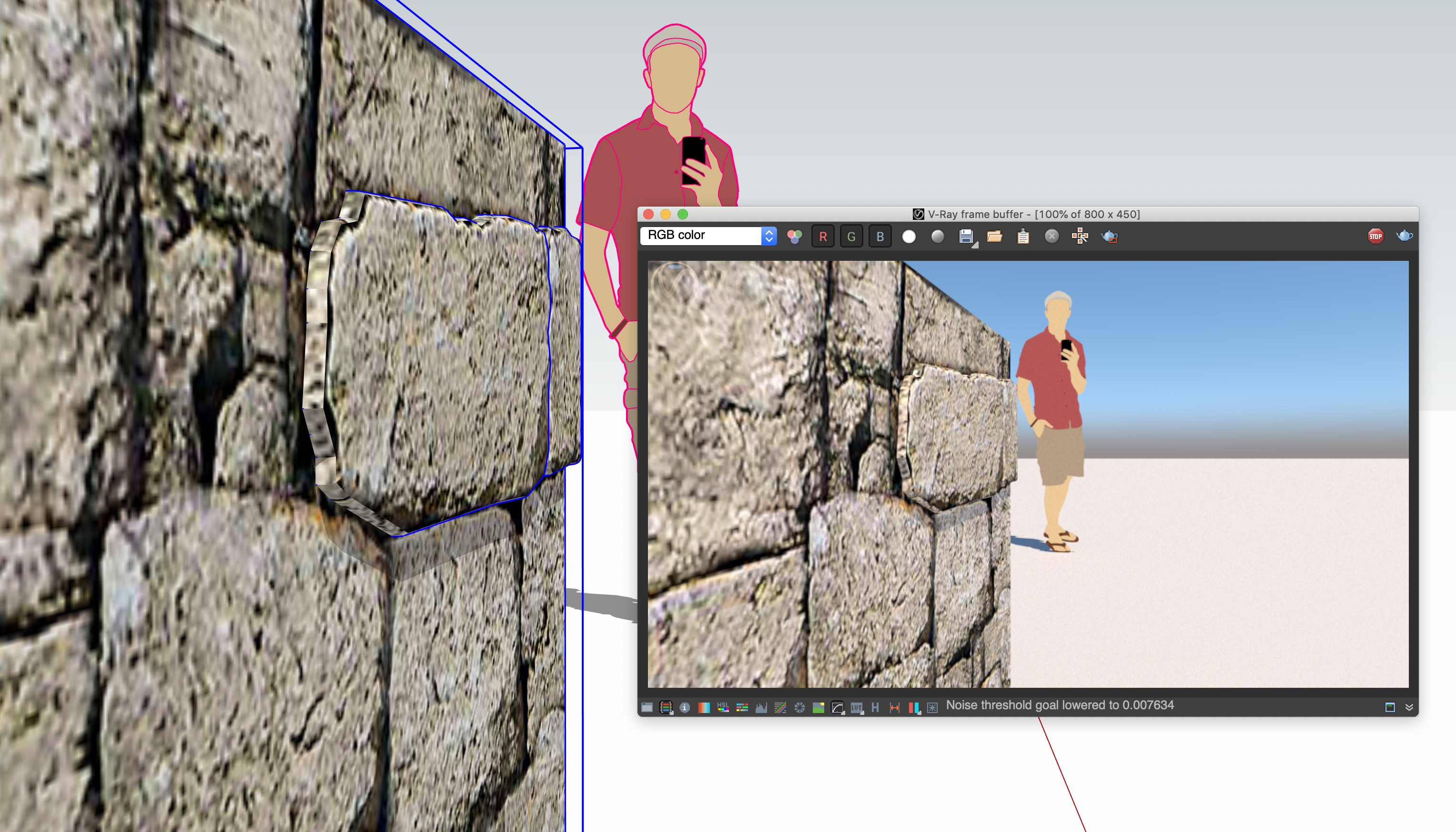

What rendering program are you using? The fastest way is to use a bump map for the rock surface itself. For the edges…that’s a tougher one as there are really are no ‘fast’ ways to do it as you’ve requested):

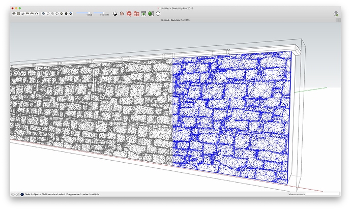

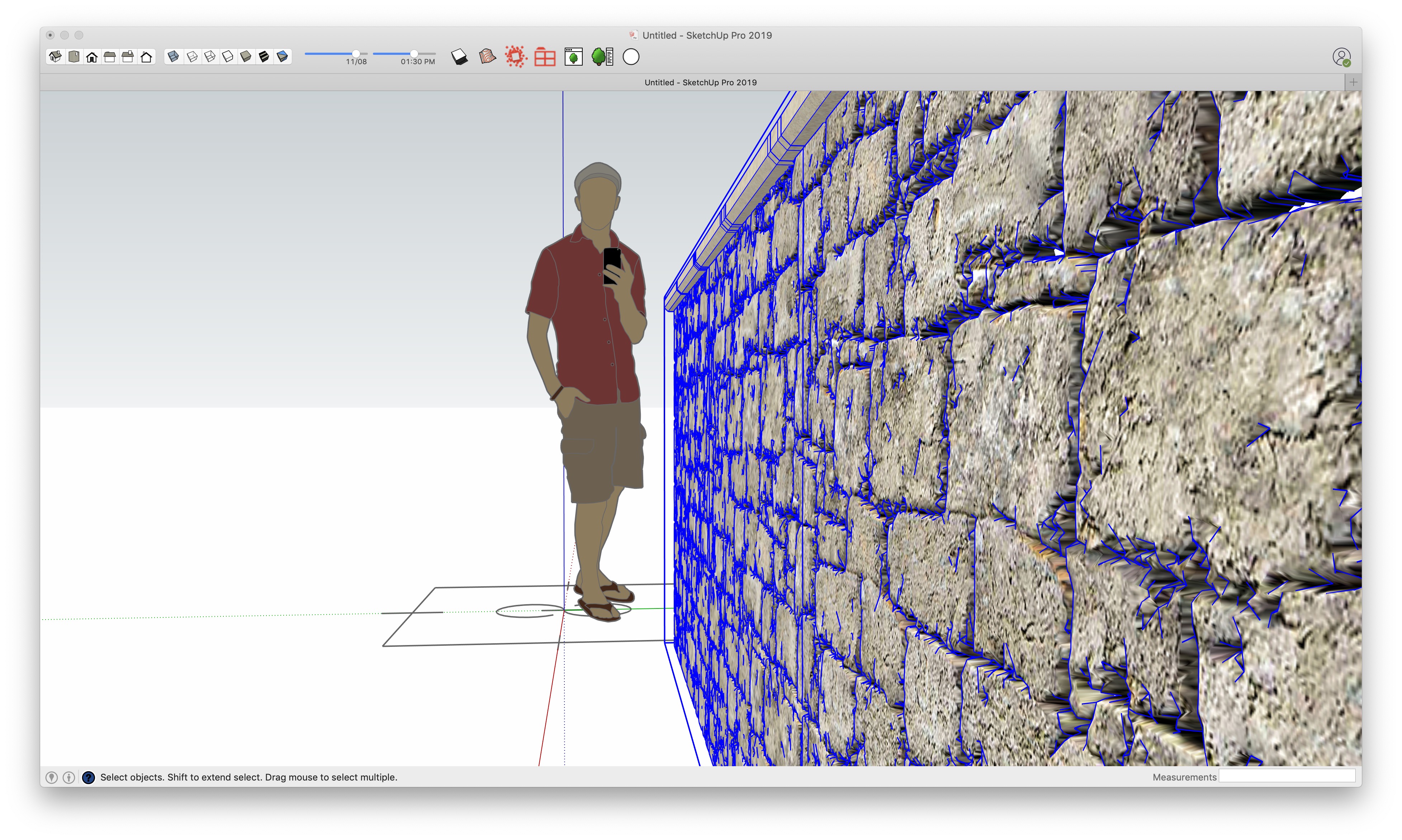

Another way to think about it is to use the extension Bitmap to Mesh to generate geometry from that stone texture you’re using. See below for example:
If that’s too much for you then you can also tracing the rocks individually, extruding and applying something like Erodeas noted already by @MichaelSiggers or Round/Fredo Corner to soften the sharp corners.

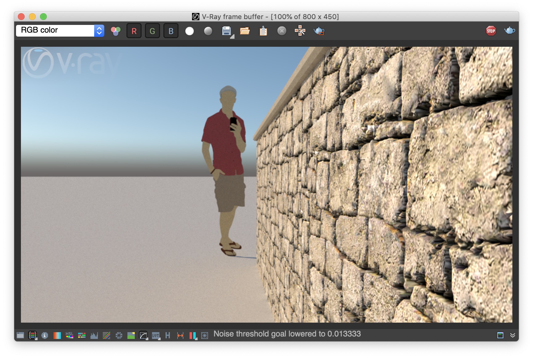

I’d recommend using a displacement map for this inside of the renderer. It allows for it to be rendered as uneven, while keeping a light weight, easy to work with model, representing the “theoretical” geometry.
This is great, thanks so much! I ended up using the enroth plugin which worked pretty well. I’ll have to check out the FredoCorner extension as well. I appreciate it!
