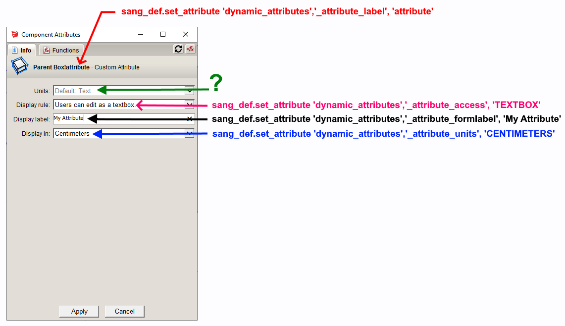

Hello,
I continue on the same subject because the question is also on the options of the attributes.
In the image below I manage to configure almost all the options of a dynamic attribute except cella with the question mark:
I have done a lot of research on the web without success!
Do you know how to do it?
Thank you in advance for your help.
Just install an attribute inspector extension and look at the “dynamic_attributes” dictionary.
I use: Attribute Inspector by Aerilius
FWIW … the answer is "_attribute_formulaunits" with values:
"FLOAT", "STRING", "INCHES", or "CENTIMETERS"
Well done, it works wonderfully!
I just tested Attribute Inspector and found it to be a wonderful plugin.
Thanks Dan for your help. :slightly_smiling_face:
For your information, none of this internal implementation is public API. You can investigate it yourself and try to work against it, but it is not advised.
