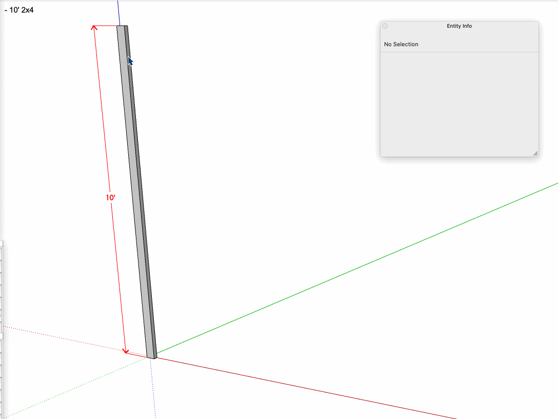

A simple way to do this is the make a component as a 10’ 2x4 and distribute them as needed throughout your model. To change a size of a 2x4 employ the scale tool TO THE OUTSIDE of the component bounding box centered on the the long axis. This scales that particular instance only without changing the size of other instances and without breaking the instance link so that the total component count of 10’ 2x4 remains accurate.
