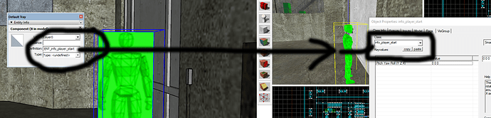

I’ve started using sketchup pro 2017 to make gaming maps, where I export them as .vmf files and then import to hammer.
I need a work around where I can call components the same names for example a square callled ENT_info_player_start and a cylinder called ENT_info_player_start. I need them to have the same name.

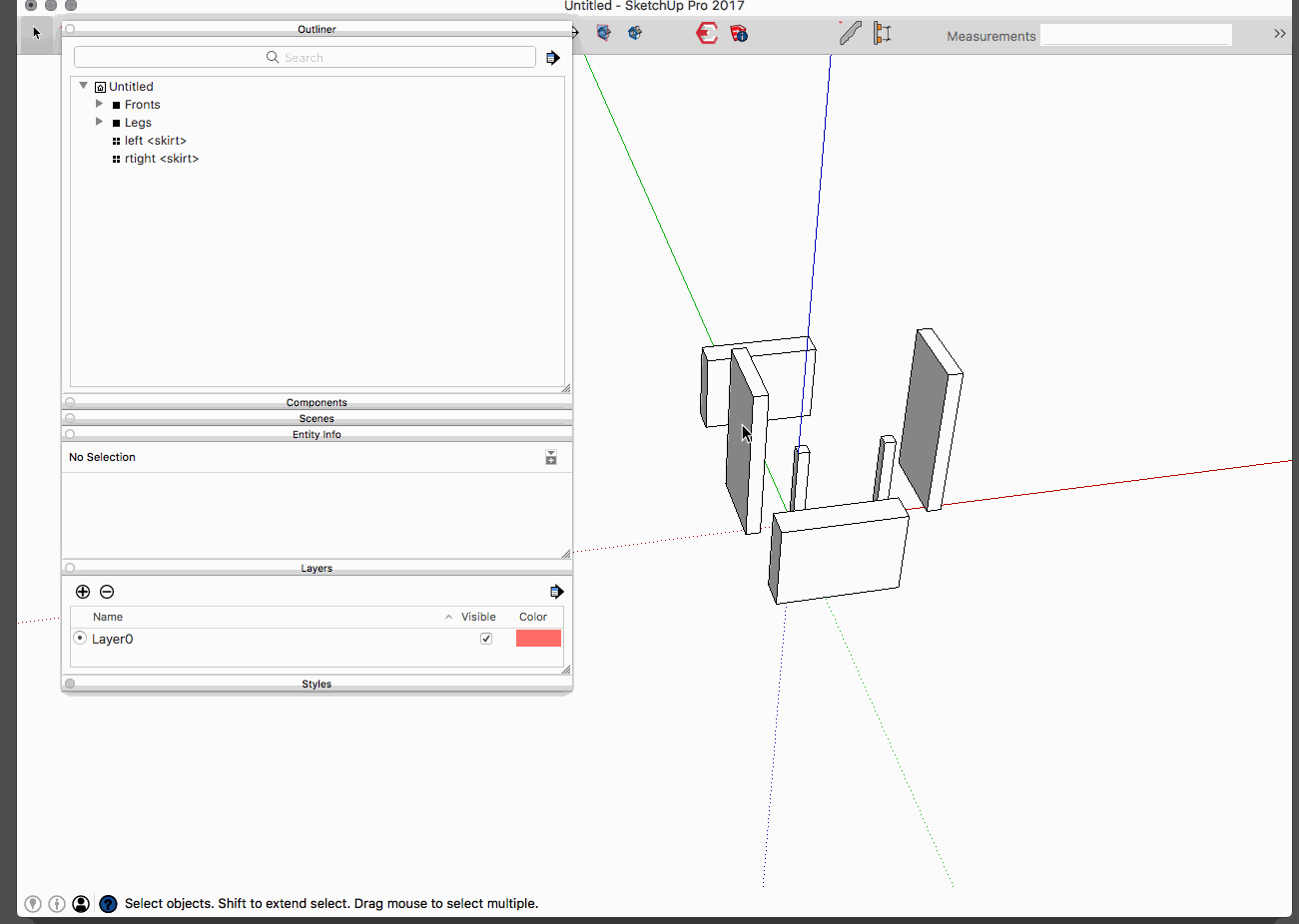

I’ve added some pictures of this where it says it’ll be replaced. Is there a work around to tell sketchup not todo this.

I’m using hammer it’s a 3D source software. The definitions were are the codes for the game so ENT_info_player_start is. A starting point. It there are others like ENT_function_door. And each geometry is different. The great thing with sketch up is its more user friendly than hammer.
There are loads of commands but the definitions are all the same.
That is not what a definition in SketchUp is. Each definition in SketchUp must have its own name to distinguish it from other definitions. I haven’t used hammer in years and never imported SketchUp models to it so I don’t know how that process works. However it seems like hammer uses the phrase definition for something completely different, something that much more resembles a layer in SketchUp than a definition name.
I don’t have hammer installed on this computer. Could you share a printscreen of the window that lets you define an object as ENT_info_player, ENT_func_door etc?
The Definition name in sketchup relates to the class name in hammer.
So I need to have the same for things like doors, buttons, actions etc. which in sketch up all start ENT_
then the hammer class reads anything after ENT_.

OR perhaps if the exporter is using the component-instance name - which defaults to “” - this snippet when run in the Ruby Console [copy+paste+enter] will rename all component-instances to match their definition-name…
That might fix things ?
m=Sketchup.active_model;m.start_operation("inamer",true);m.definitions.each{|d|next if d.group? || d.image?;d.instances.each{|i|i.name=d.name}};m.commit_operation;
It is one step undo-able.
