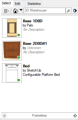

Component Browser Thumbnails generated in SU2020 (windows only)
Saving a component to a library (using the context menu>save as) results in a thumbnail with top-down view of the component. This is a changed behavior from previous versions where you would get a thumbnail generated based on how the component was oriented in the model.

I’ve tried several times to do what you have said, but am unable to get a component thumbnail back to a perspective view.
I’ve disabled all non-SketchUp extensions and used a sample SketchUp component. When I save it as a component, the newly generated thumbnail is always a top-down view.

Seems like the latest updates to Sketchup 2020 broke the thumbnail generation so the thumbnails are only generated from the top view when you Right Click > Save As. Same issue when saving a component through the API.
I work quite like Palo and I also noticed this strange action. I also use Component Finder. I will still observe and test, but it seems that it is the add-on that overwrites the preview of the component. When I save a component from the context menu (right-click on the component) or from a native component list, the preview is saved correctly.

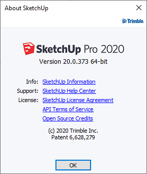

@Palo Which version of SketchUp are you running (see Help > About SketchUp…)?
I’m only finding this issue on SU2020 on the Windows platform. The Mac version is working as expected.
