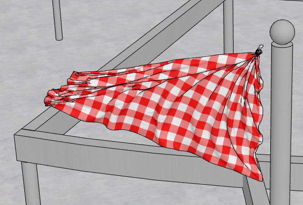

I just looked at your SketchUp file. If you move the flag group out of the giant component, Clothworks will show in the Context menu and you can make it a cloth. The cloth group/component needs to be in the top level.
I would also like to be a loyal citizen of Tableclothia.
