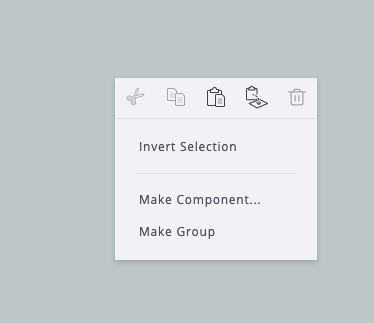

When I am working in Sketchup Web, after a while this click menu starts appearing where I left click on the scene. I need to reload page to make it hidden. Is there a way to prevent this or make it disappear without reloading the page?
What browser are you using?
Chrome Version 94.0.4606.81 (Official Build) (x86_64) on Mac OS Big Sur
That shouldn’t happen, but would if for some reason your Control key was sticking.Try pressing that, to see if the problem goes away.
Thanks a lot! Pressing Ctrl key a couple of times solved the issue.
