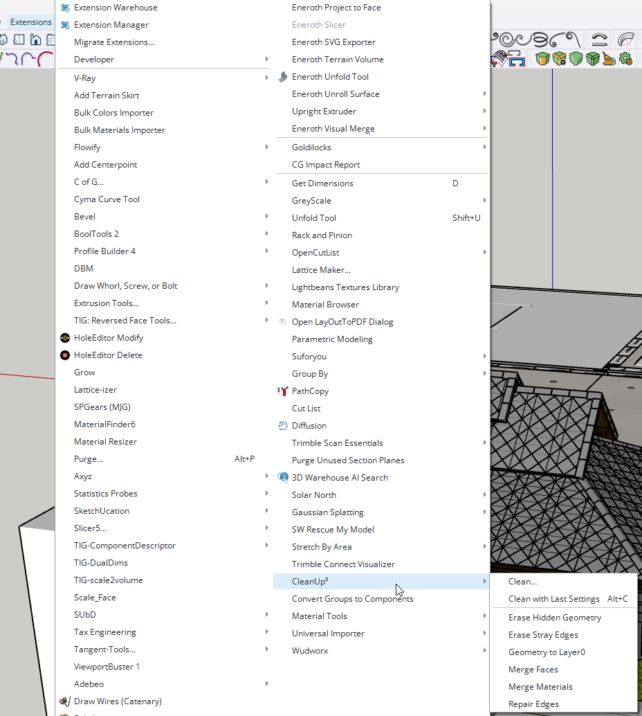

Maybe you need to look farther down the list? It won’t show up on the toolbar as it has no toolbar button.
