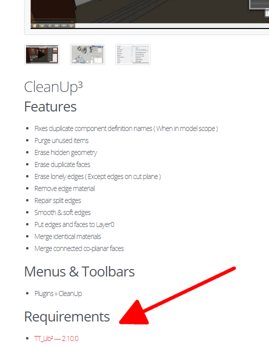

Most common reason why CleanUp3 doesn’t work is the user fails to also install the required TT_Lib files, too. No amount of uninstalling and reinstalling SketchUp will fix it.
