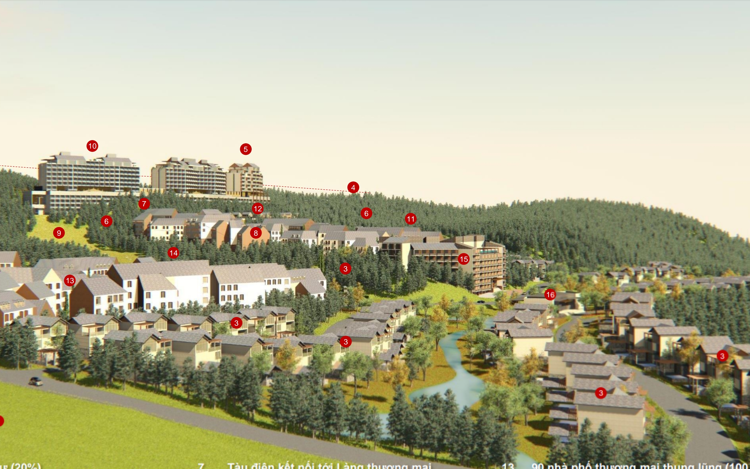

You definately need to look at Valiarchitects extensions for roads and toposhaper by Fredo… both massive productivity tools for 3d terrain work
Example below of approx 100 hectare site, 1km x 1km with roads cut into terrain
PS, for those interested his is a snapshot from my SAMSUNG Tab S4 using Sketchup Viewer Android app, handles the file easily…
Trees added in Twinmotion 2016
PS… we patched this detailed terrain into a 3d terrain of the surrounded area covering approx 12km x 12km
Also we had no CAD vector data for the site so I hand traced the PDF contour plan In Sketchup… then used Toposhaper to refine and elevate the contours…

Is the background hill, too, covered in Twinmotion trees?
No, trees were limited to the 1km x 1km area
I used different materials to define, forest, parkland, road verge, grass, ski slope and landscaped garden area then them asked TM to map trees / grass/ shrubs etc to those areas automatically. very quick… almost instant and renders, although not high realism only took maybe 30 seconds at 4k and then straight into powerpoint … it was for a feasibility study… only 4 weeks from start to finish. modelling was 90% rendering / presentation 10%

all done from scratch in SU… only had a dwg outline of the boundaries and PDF of a contour survey of the site.
  1. So took a high res screen capture of the PDF,
  2. imported and scaled it to the imported dwg in SU,
  3. created a separate translucent ground plane in SU over the scan
  4. traced the contours onto that plane [in top view ortho]
  5. isolated the contour traces
  6. used Fredo’s TopoShaper plugin to optimise, lift and form the terrain surface
Of course if you have a DWG contour plan you avoid having to scale and trace them… so much quicker
For the roads, a similar process
  1. create a translucent plane over the site above your model and terrain…
  2. draw your road centrelines on that plane in plan [ortho] view looking at your model below
  3. use "Instant Road Nui " to project those centrelines onto the terrain as roads.
before doing this always backup your raw terrain model as a separate SU model
as is it easier to start on a fresh terrain if you edit the road positions.
PS, I also use Artisan for terrain refinement, smoothing, face subdivision, stitching edges together etc…
