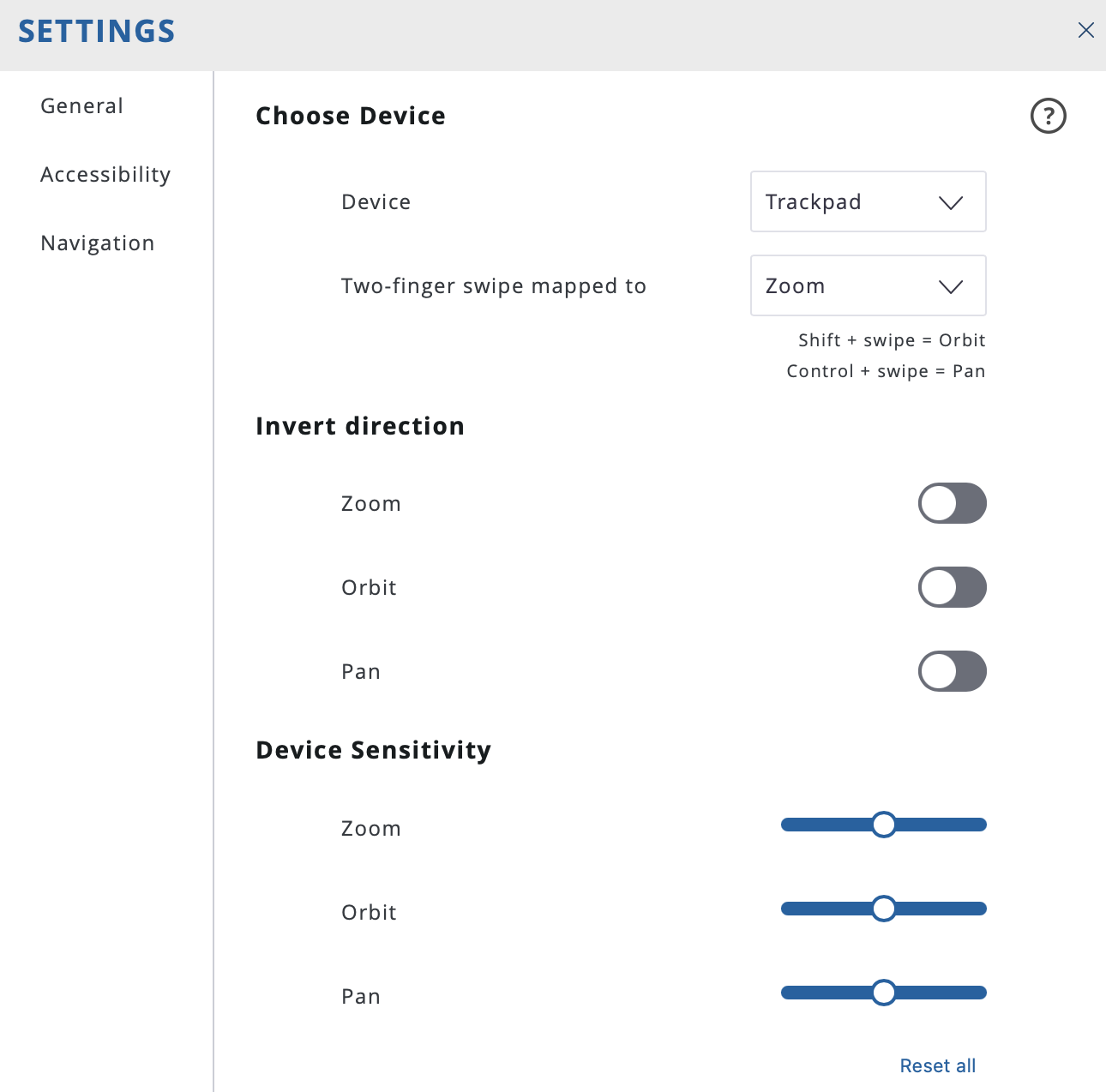

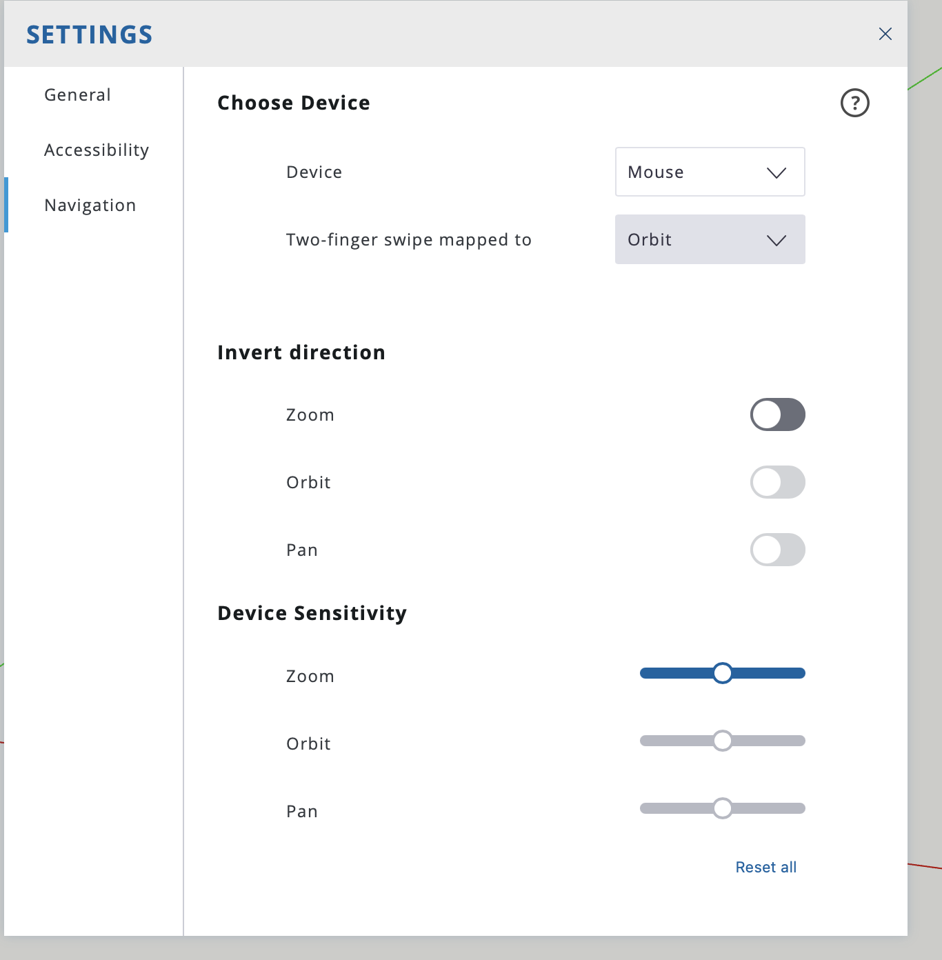

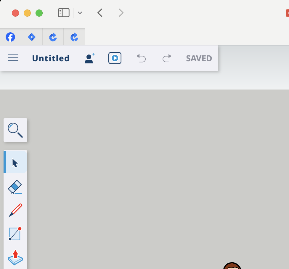

If you click the magnifier to search, and type Settings, you can then go into Navigation and invert the controls you want to invert. Or change whether you are using a trackpad, or what action happens when you use the mouse or trackpad.
Hi Colin, thanks for your help. I just tried to do that but it doesn’t let me, presumably because I’m using the free version. But I’m sure that is the answer I was looking for. Cheers!
on a mouse, orbit and pan are locked. if you move your mouse to the right, then it’ll orbit or pan to the right.
only the zoom (scroll wheel) can be switched.
on a trackpad, everything can be switched because many people are used to inverted manipulation using a touch screen.
so if you want to have the orbit work like the default mac os UX, then you have to select trackpad first, and use the trackpad to navigate
