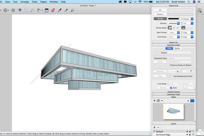

I’ve created a chandelier model in sketchup and I’d like to make the lines / stroke thinner so it makes the image look less heavy handed. Do t think I can do that in sketchup right? If I export to layout I can’t figure out how to make the stroke weight change impact the model I imported. Can I change the stroke weight of edges in a model I created in sketchup but brought I to layout? Is it possible to do that in sketchup? Thanks. Scott
If you select the viewport in LayOut you can change the Line Scale to change the weight.
There’s no line weight control in SketchUp. You can adjust the weight of profile edges but not other edges. In LayOut the line weight setting is for all edges in the viewport. There are a couple of options for allowing finer control over line weight. The best is probably stacked viewports with different tags visible.
