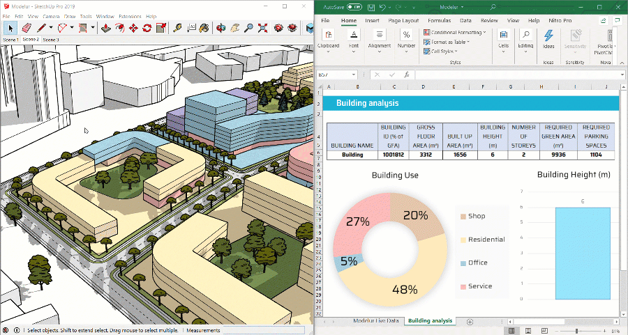

I imported a CAD file into sketchup for a uni assignment. All the buildings have gone black. Is it possible to change them all to one except for the ones I’ve already changed to blue as they are on my subject site. The file is too big too attach but i’ve attached a screenshot. As you can see the houses are all individual components so in order to change each one’s colour it would take wayyyy too long. I am trying to make a drawing similar to the attached.

Hi Colin, Thanks. It does look better. It also helped me to discover turning off all edges as below. It looks great but It would be good if I could keep edges on for the main buildings (or just to show the levels of the buildings) - blue and red. and for the roads as well. Is there an easy way to do this?
Applying different styles to different objects is a long standing Feature Request.
