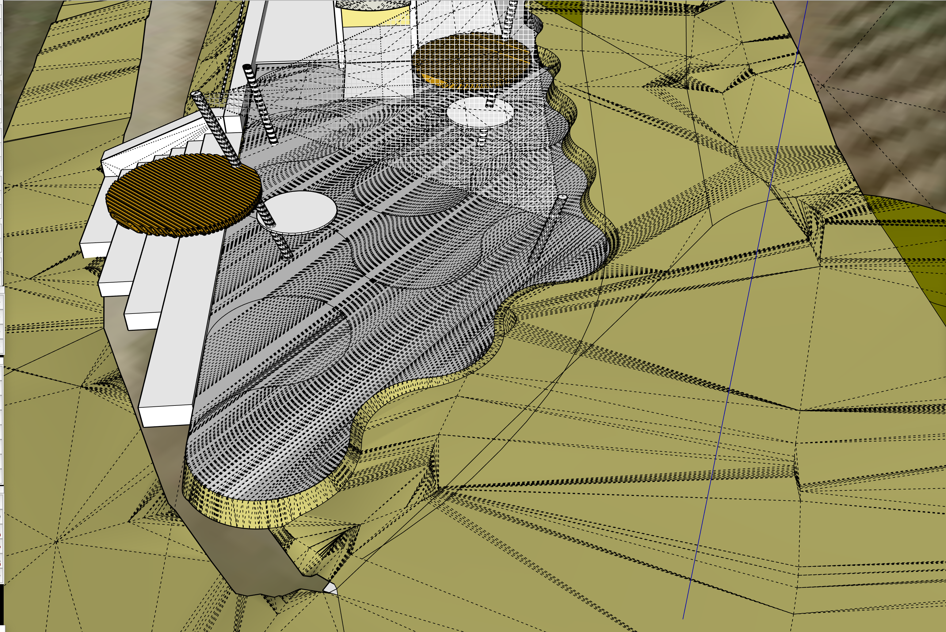

TEST.skp (14.5 MB)
Did you want something tested on this file?
Is this file imported geometry from another file format?. There are a lot of coplanar hidden lines.
Only the canopies. It was created in Autocad 3d, the rest of the drawign was drawn in Autocad 3d.
