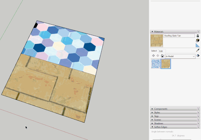

You have to select two coplanar faces painted with different materials and at least one of them must be a texture.
okay Dave… got it, thanks.
