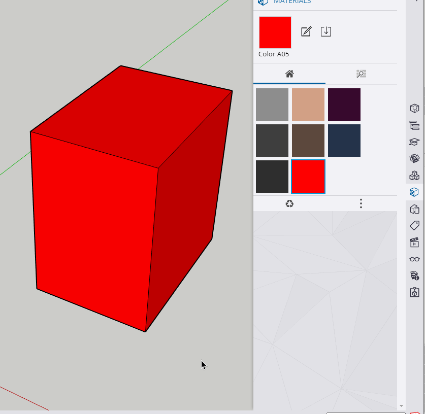

I don’t think I can because there is nothing to show don’t think I can because there is nothing to show. When I pick a new color in the edit window, it briefly shows the new color and then reverts back to the original and exits the edit function.
This is what I see in SU Shop.
Thanks. That was helpful. I logged off the website, logged back on, and it works just fine. Go figure.
