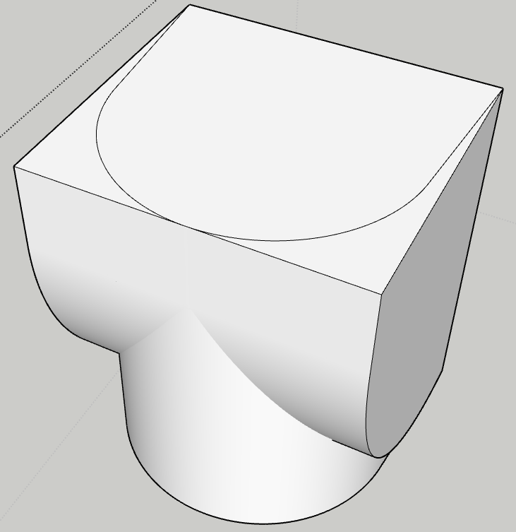

I am trying to get intersection ot these two objects
After positioning them one over other
I have selected faces to intersect
and applied “Intersection with context”.
Then I got lines of intersection
And now I expect, that selecting this area will select only part ot edge “below” the blue line.
But lookng from face side I see that the edge entirely is selected.
What I am doing wrong, and how to fix it?
If you made them solid you could use the solid tools to give you the intersected shape.
What do you mean?
OMG, you are so right! I did it.
He means solid tools. In SketchUp Pro.
