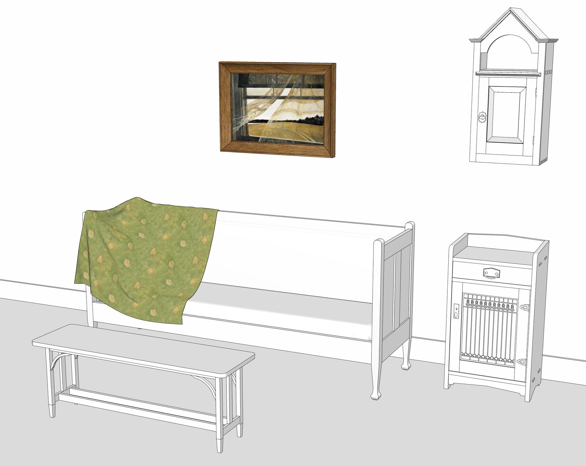

A style is an all or nothing sort of thing. Doing what @Danimaupin suggests is one option. Another would be to use LayOut with stacked viewports using different styles. Another simple option is to make several image exports and combine them in an image editor as I did for this image.
Another option would be to use FredGhost as I did in the following image.
