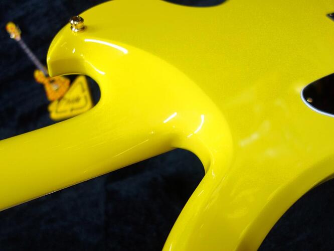

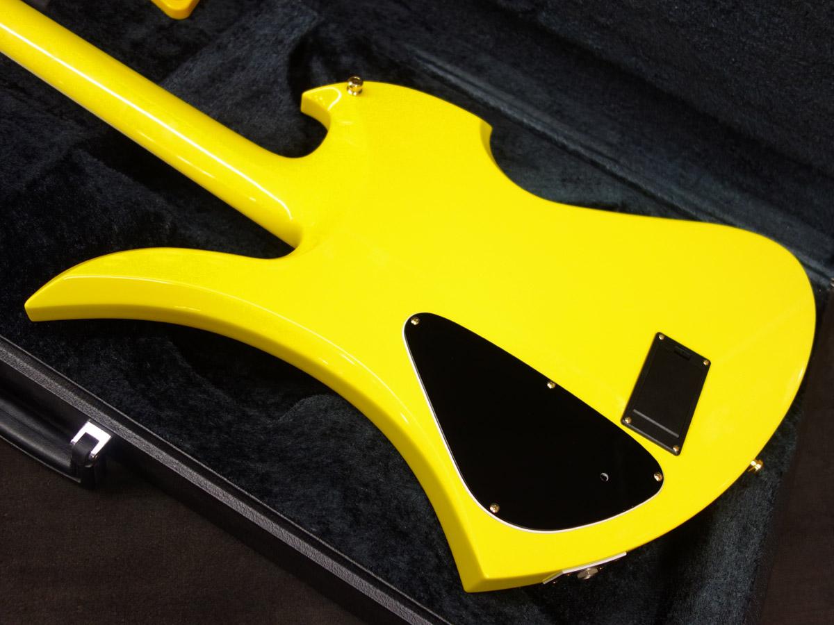

I’m trying to model this guitar and I’ve done pretty much everything, now it comes down to where the neck and the body join, I’ve tried all the method I can think of but nothing seems right…
the bottom pic is where I’m stuck now

I did find a link for this guitar, http://store.ishibashi.co.jp/ec/pro/disp/1/10-312566500
But the neck and body are two pieces, with very nice sanding and painting.
Here’s a better shot of the neck to body http://www.fernandes.co.jp/wp/wp-content/uploads/2015/04/back-shot1.jpg
And it might very well be a through neck.

I did try connecting with the same way I did the neck, like a Y direction,but the curve will look very " thin"
