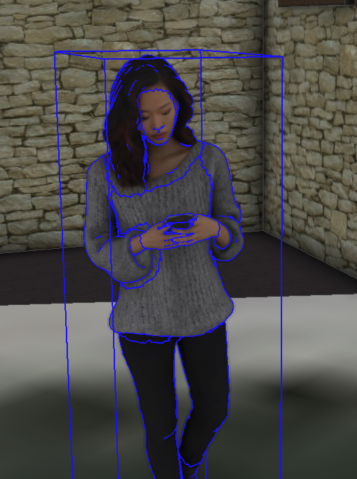

again, CG impact report doesn’t flag anything as too over modelled, this person seems to be a bit on the high poly side, she is in 3 places for a total of 200k polygons.
good looking 3d people, where did you get them, the warehouse ? I’ll look for them :slight_smile:
overall it’s a clean model, just one bloated material, a couple of raw tagged geometry… hats off to you :slight_smile:
