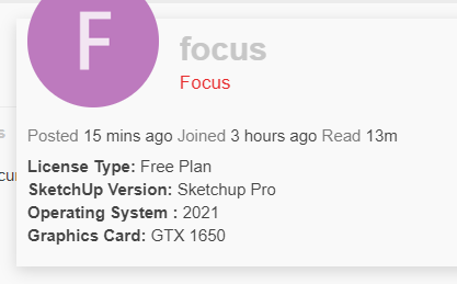

What version of SketchUp? Your profile makes no sense. There is no Free Plan for SketchUp Pro and 2021 does not identify the operating system.
Screenshot - 6_11_2023 , 8_37_22 AM
sorry by mistake.
SketchUp.Pro.2021.21.0.339
Windows 11.
GTX 1650
Please fix your profile.
