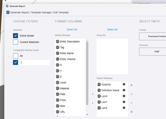

In SketchUp 2024 and 2025 (on macOS 15.5 Sequoia), I am encountering a bug when generating the quantity report. See the screenshot below.
The generated table does not separate the different elements and, moreover, the “Definition Name” column is empty.
Can you show the setup of the template? I just made the following template …
… and this is the resulting report.
