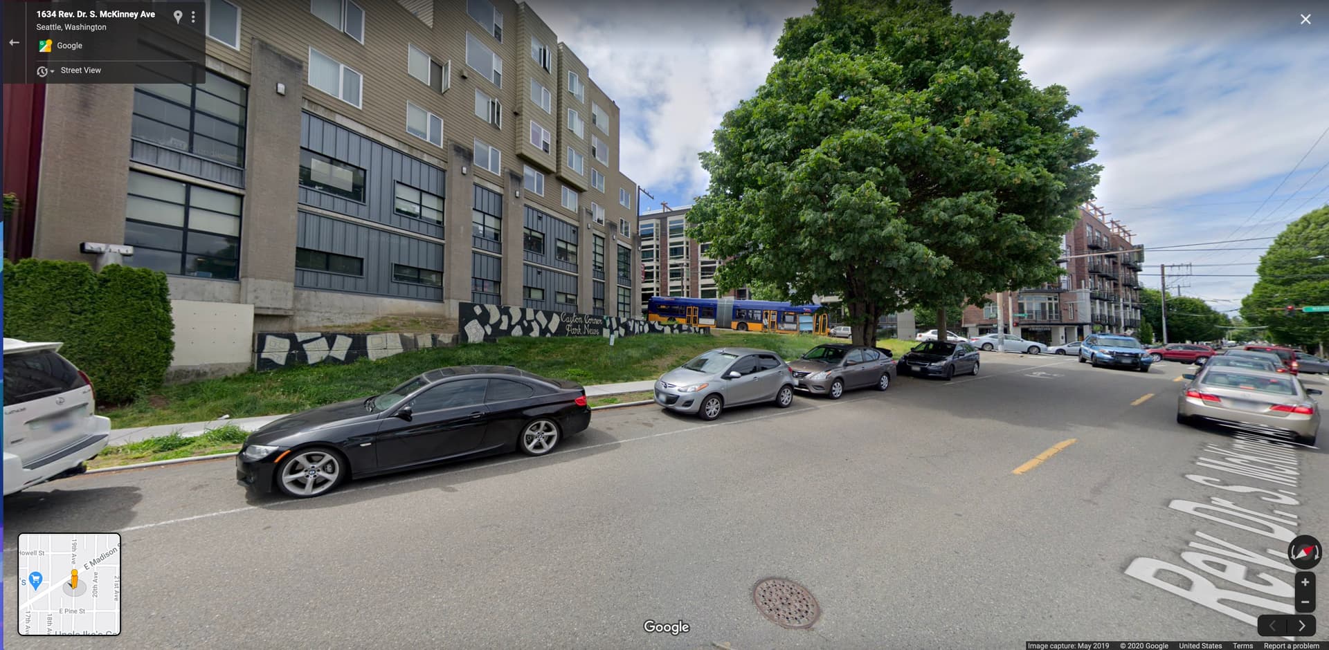

Use your own photo or capture a screenshot of the angle you want to place your model into:
In the Styles panel in SketchUp, add this image as a ‘Watermark’ and set it to the background and rotate, pan, and maybe adjust the camera’s FOV to get it to line up best you can. To get fancy, you can have two watermarks, one in front and one in back like I have here so that the cars and existing tree actually ‘cover’ my design model. *note I’ve faded the watermarks so that you can see them better compared to the model.
Here is the final view. Repeat process for multiple views making sure to save each as a new Style:
