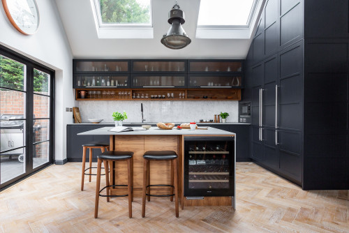

Regarding your kitchen, however, you can capture odors using an extractor fan… Most apartments we design have open plan kitchens with island benches, for casual dining and entertaining.

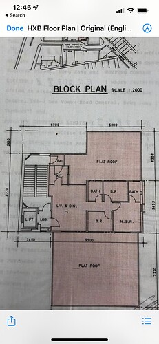

Wow, three bedrooms but a kitchen the size of a broom cupboard?
I also don’t understand the door to the “Bal” (balcony?). There are doors to it both from the kitchen and the half landing. But the half landing is down a long flight of stairs, so how can the levels work?
It’s not clear, but I’m guessing that’s a scissors stair, so the two flights are two intertwined stairs, and the balcony provides the second means of egress. Scissors stairs aren’t considered ideal for for providing two means of egress, but when there’s so little space… It also means you have to travel one full story in a single straight run.
Yes, that looks really tight, and all you could do there is some sort of galley kitchen as you have to be able to walk through it.
How many people are going to live there? IMO the area is good for about one bedroom, living room and an open or enclosed kitchen (in our parts you may not call anything below 7 m² a room).
