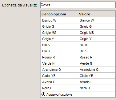

I have a list of materials like this to select the color of the Component:

Now, i want to have another attribute, hidden because it is only useful for my report, that should do this:
If the material selected is Bianco W, then it should show a W, and so
I tried to write =if(material,bianco W)=w but it wont work :confused:
=if(argument, result is true, result if false)
=if(material=“Bianco W”, “W”, material)
to include all
=choose(optionindex(“attribute name”), “W”,“G”,“MS”,“Y”,“K”,“S”,“N”,“O”,“YE”,“I”,“B”)
so it choose the letters based on the list index, with correct attribute name

The thing is, a have to be able to choose the material, as you can see from a list, and i need it to be seen like this, with the name and the letter “Bianco W”(white W), this because this component has to be used by other colleagues.
But in order to generate re report, i was requested that it has to be shown only the letter, thats why my intention is:
If in material is selected Bianco W, in the attribute “distinta_colore”(report_colour) it should be shown W, and so with the other materials/colours from the list.
