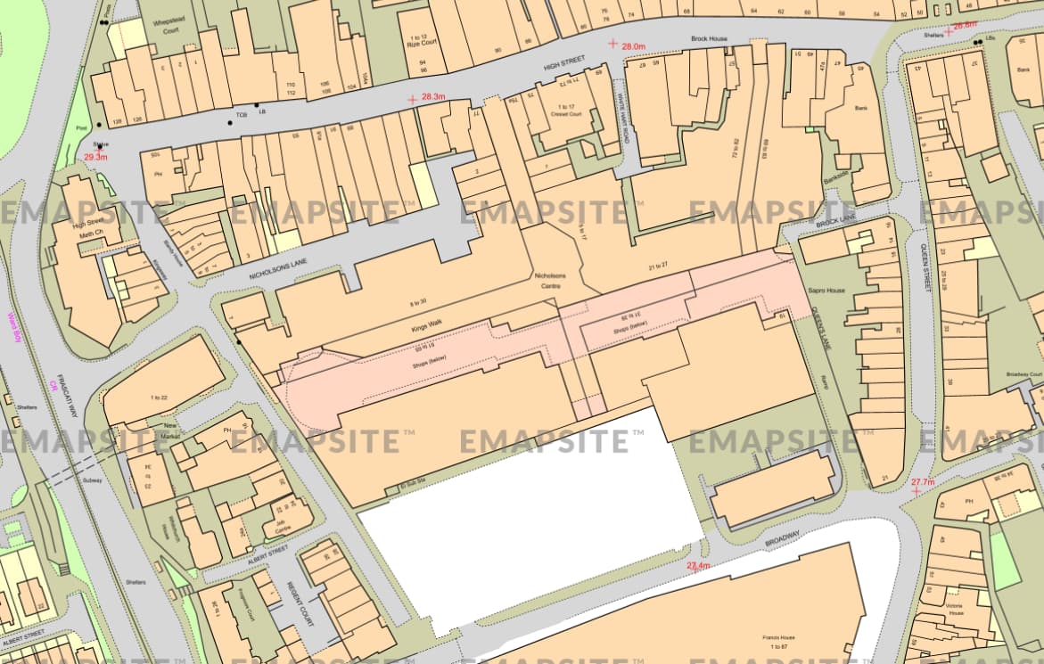

Does anyone know how I can make my QGIs map look like this?

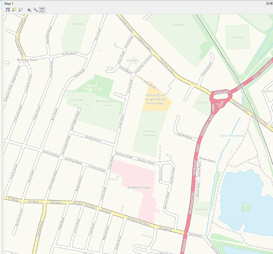

It currently looks like this in QGIS:
I have downloaded the OS Open Zoomstack from the OS website. Am I missing something in the install process?

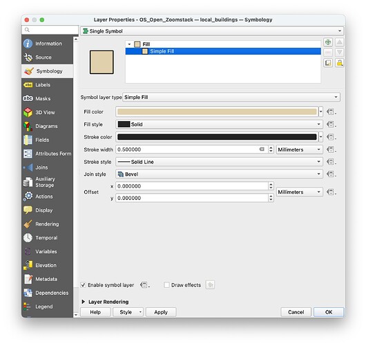

By ‘looks like this’ do you mean that it has visible borders for every parcel?
Or are you referring to colors? Or something else?
For borders, change it in Style.
that’s one element of it. though even if the parcels were separated by black lines mine would still be missing features and details that I don’t know how to obtain. As far as I’m aware they are both using the same OS map data.

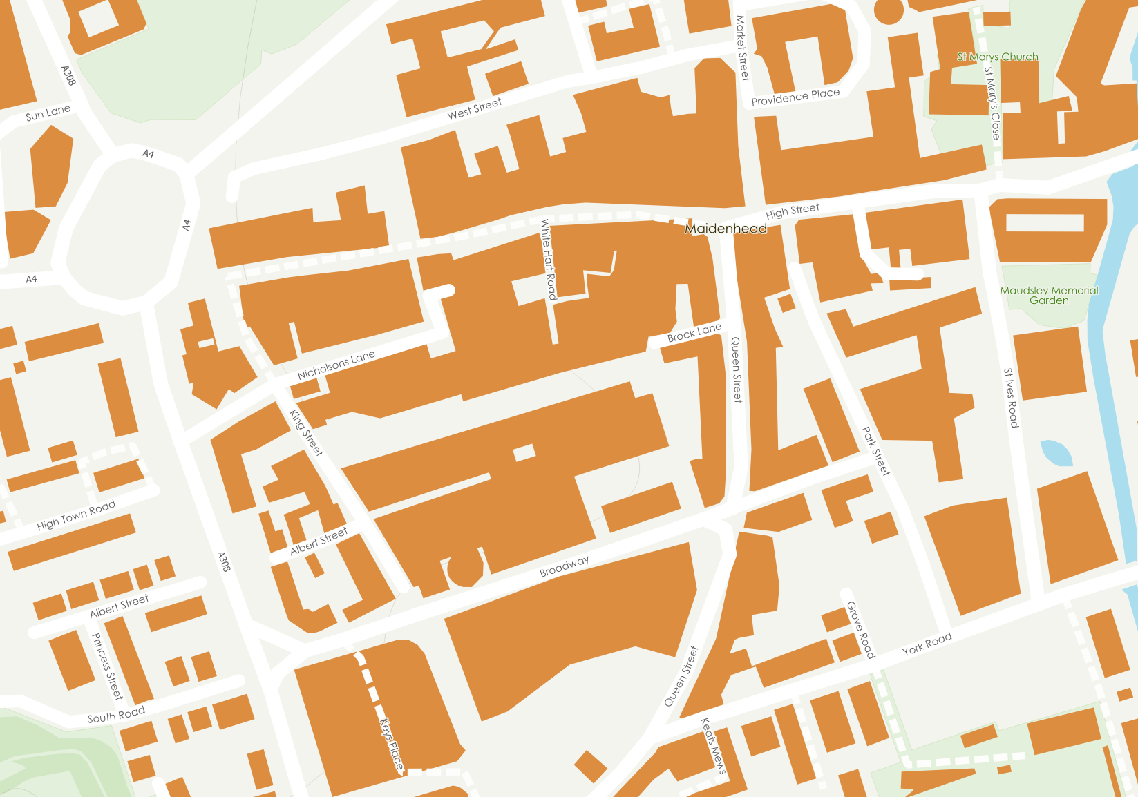

I’ve got it to look like this , I’m not sure if that is better or not

Here is my attempt at just matching the overall look and feel of your reference. I can confirm the dataset fm the link you provided does not include any spot elevations or house numbers. EMapStite, the reference you’re trying to match is a provider that I’m sure does or adds something in addition to the raw dataset - therefore you won’t be able to match 1:1. That’s likely why they’re in business, to do this work for you.
To match the Style settings, all you have to do is play with the layer stack, see my example for ordering so things show correctly. Then play with the colors of the shape layers, and stroke widths of the line layers. Note you can’t get things like curb radii as all we’re working with here is road centerlines. Again, that information must be have been added from another dataset or drawn in.
