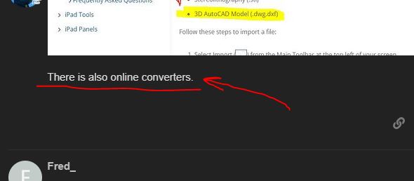

and DWG, DXF (Google search)
There is also online converters.

Without an iPad, I just looked at what it says on the official SketchUp page and saw that it imports DWG/DXF.
Hope that @MikeTadros could confirm that DWG can be imported and how. Thanks!

I just tried importing both a .dxf and a .dwg file to SU for iPad and it worked. These were both 3D files.
So I guess the problem is converting one of the file formats that one of the LiDAR apps exports to.
I suspected, so I already gave you a solution for this in the first post.
stp-02
Thank you, Mike Tadros, the dwg import issue is resolved!
