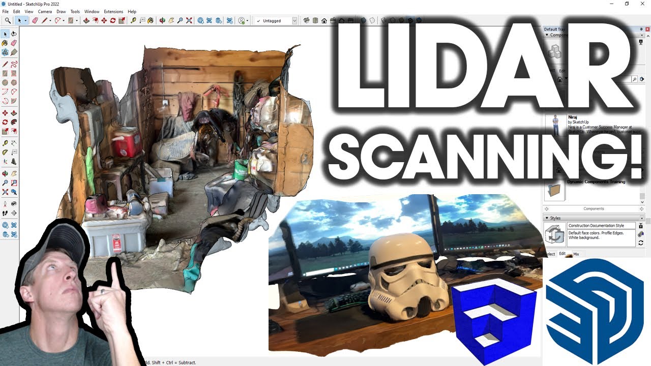

Just found these helpful videos where Justin Geis talks about his use of Polycam on the iPhone and SU. I may use some of his tips. His videos taught me the basics of Photo matching which you could use in conjunction with the Lidar scanning.
