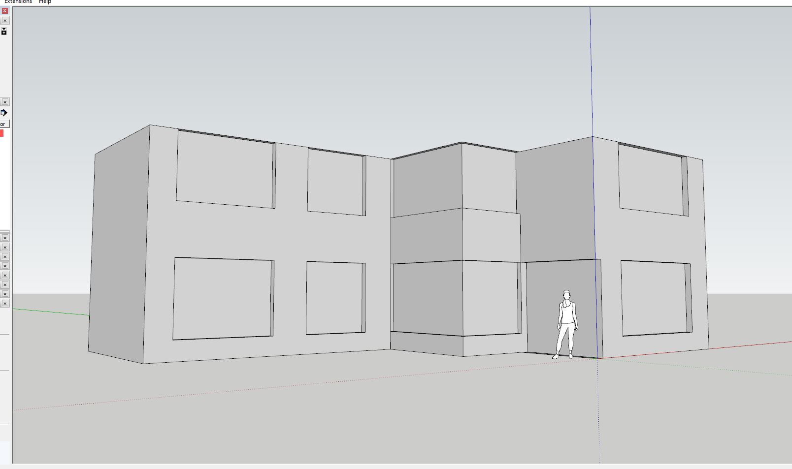

pretty sure the problem here is that the verticals have been straighten.
therefore, the photo is not in perspective anymore. on the example provided, you can see the blue line is where the house corner should be if not made vertical.
