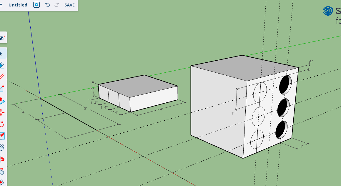

FWIW, we have completed some work (developing ideas and demonstrating understanding) using the midpoint tool, segment creation and linear dimensioning. My students love it and I am trying to expand the experience for them
For example, my students created a large “die” (singular dice) with dimensions of 4’x4’x4’. In that case, students noted particular dimensions in terms of overall dimensions, circle locations, etc. I am including a screenshot here, I hope it shows up as I am responding to your question via email (and not directly in the SU forum). We utilized: line tool, dimensioning tool, midpoint location, segment division, circle drawing, rectangle drawing, push/pull
