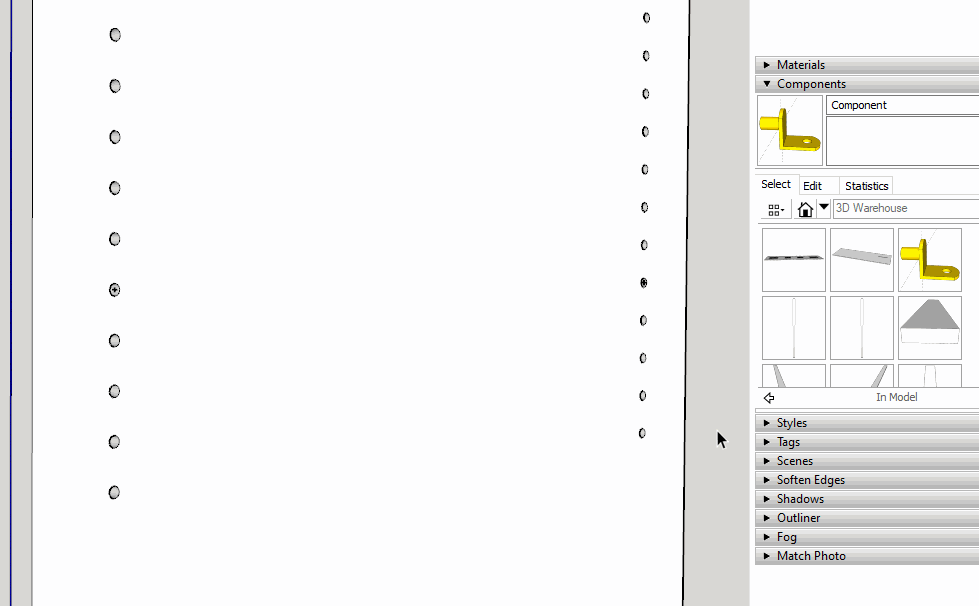

In this case I’ve placed guide points at the centers of the holes where I want to put the pins and dropped the pins on those points.
sp
Although it’s a good exercise in learning how to manipulate objects in SketchUp, I would just delete the misaligned shelf pins and move on. Since the pin is a component you can bring another copy out from the In Model components. It’s easier than fighting with the ones that are there.

The first thing I did is rotate your model so it is correctly oriented relative to the model axes. As I told you to do, just delete the misaligned shelf pin components and bring a new copy out from the Components panel. I showed pulling the component out of there. I used Change Axes to set the component’s axes so its origin is as I showed, above. Then it was simple matter of dropping the component in at the guide points at the centers of the holes.
axes
