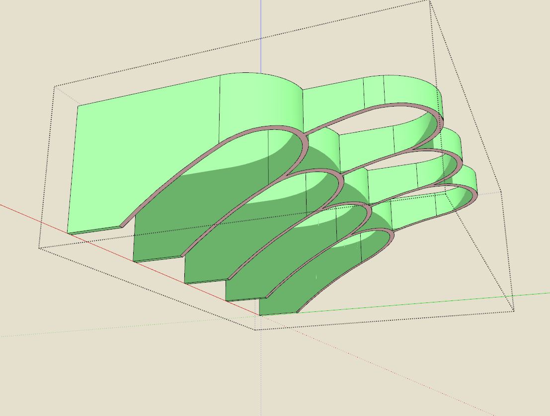

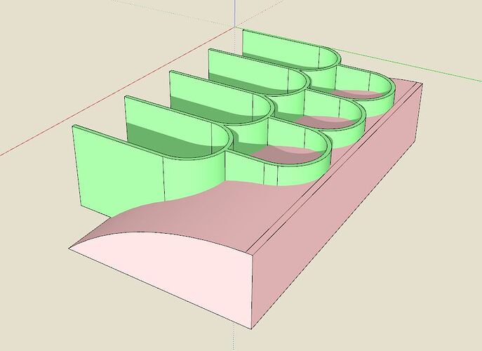

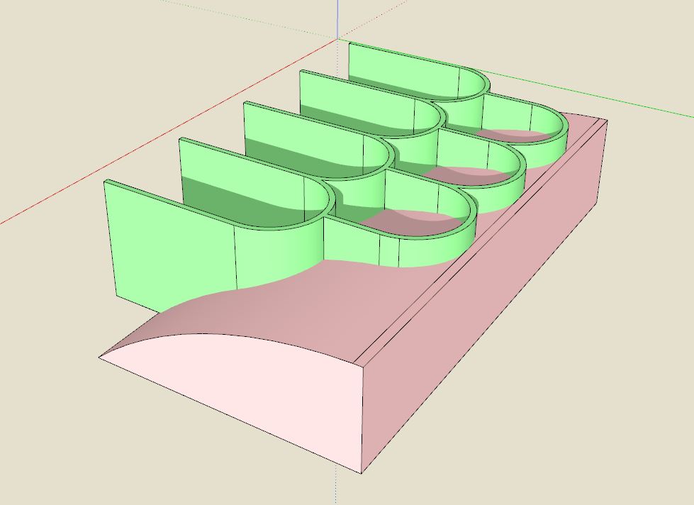

isn’'t the underside curve just an arch shape… and the patterned curves just a pull down extrusion of a 2d outline… just use solid tools to subtract the arch from the extruded profiles ?
