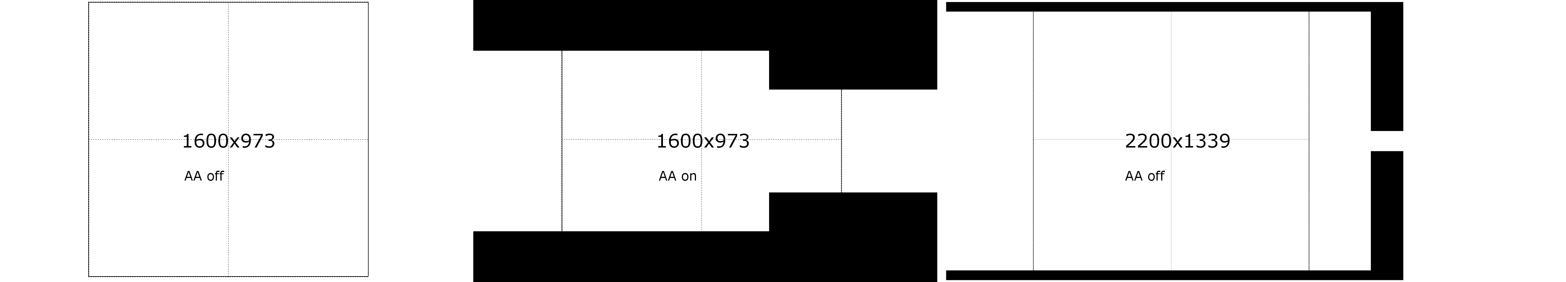

I use Sketchup Pro 2017 and here are my test results:

I am 99.8% certain that the physical monitor has nothing to do with what you get when you export an image. The top contenders for these problems would be
- Display driver
- Some other plugin (a rendering plugin would be the prime suspect) messing up the Advanced Camera plugin
- A bug in Advanced Camera.
@JAlarcia, Do your image exports work OK when you use the normal SketchUp camera with no cropping?

Yes, it works perfect when i export it with a normal sketchup camera, inks for the suggestion
i dont think is the monitor, its a mac book pro. I export it with a normal camera and works. I´ll stop using advances cameras. thank you for the suggestion.
