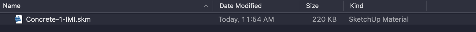

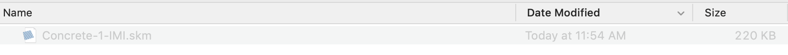

If I drag a SKM file with Finder into the “My Textures” subdirectory of Materials Folder, a message indicating the file already exists. But, in a finder window the file is not shown. I tried the old trick of option-shift-period to show invisible files, but it is not there. In SU if I open “My Textures” folder, no files exist. If in SU, I open the Materials window and try to add the SKM file as a new texture, it is not shown as selectable in the finder window. What am I doing wrong? Thanks for your help.
In Finder:
In SU “New Texture”:
