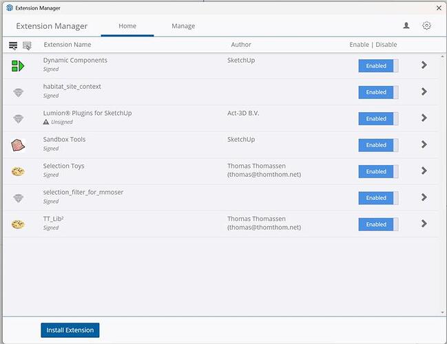

That is the main issue. It doesn’t exist in the Extension Manager either. Even when “installed” from the warehouse.
It is there but not loaded correctly. The extension registrar file is named "habitat_site_context.rb".
This is one of the distributed extension that come with SketchUp.
When you installed SketchUp, did you download the offline installer, then right-click it and choose “Run as administrator”? If not, restart machine to clear out memory before running the installer.
Also, do not manually copy over an old Add Location extension from a pre-2024 SketchUp edition (or any version really.) If you did it would definitely need to be manually deleted (as usually the latest comes distributed with SketchUp.)
You can close SketchUp, then go to:
  • %AppData%/SketchUp/SketchUp 2025/SketchUp/Plugins
and delete the "habitat_site_context.rb" file and "habitat_site_context" subfolder,
then restart SketchUp and the distributed version 1.7.3 will be redeployed to your plugins folder.
Then go into the manager and see if it is properly listed as “Add Location” with the other extension properties if you expand the card. (I.e., it should not just read as the name of the registrar file.)
Switch it ON if able.
Then restart SketchUp.
The version on the warehouse is at least version 1.7.8. The Manager should popup a window in the lower right saying at least one extension has an update. You can then go through the Manager (not the Warehouse) to update it.
Once in the manager, click the Manage tab, and you should see an emboldened Update for the Add Location extension. Click it and let it update. When it does, close the manager and restart SketchUp.
