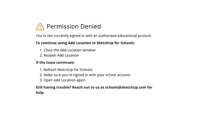

I’ve had a student come to troubleshoot why when trying to use ‘Add Location’ under ‘Shadows’ is giving her a permission denied screen. I verified she is signed in with her school account and still get the error. I have also replicated the error with my own account.

That is a new one for me @jmanaois. I am curious if you are using the regular web version of SketchUp or if you are using the k-12 version. Can you verify that for me so I can run a quick test on my end and see if there is a server issue? Also, can you post a screenshot of exactly what you are seeing?

Here is a screenshot of the issue we are experiencing:
I’m not too sure how to check what version we are using but the URL is edu.sketchup.com

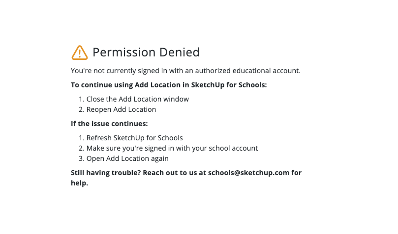

If you are in chrome, can you please click F12 (open dev tools) and try to open add location and send us a screen-shot of the errors in the dev tools console.
Let me know if this is what I was supposed to send..
That’s very helpful, thank you.
