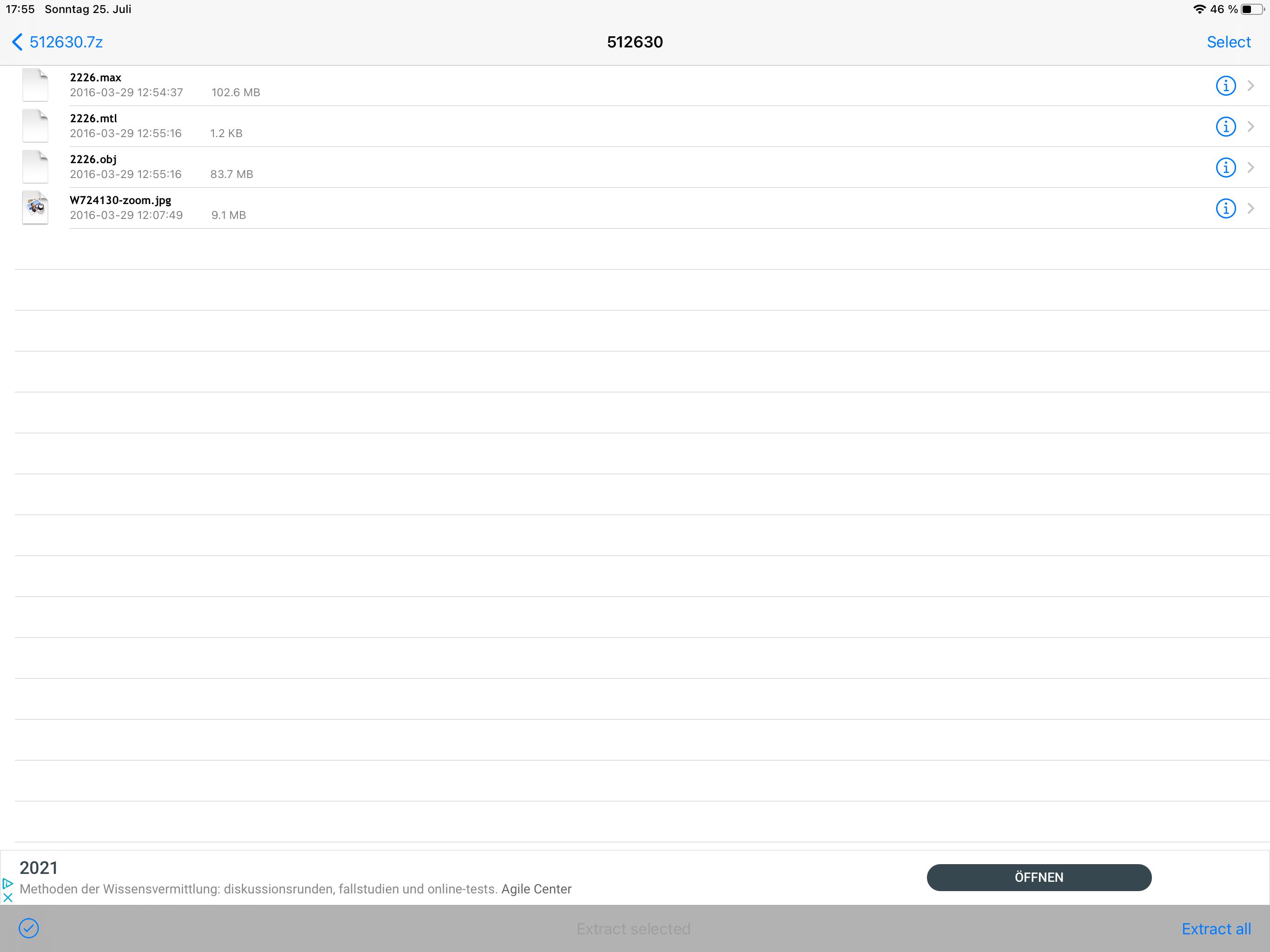

hello,
no, since you don’t have 3ds max and that .max files can only be opened by it as colin said above
Cheers
Torsten

Yes but some models are only available in .max, and others are in .obj and others available in both formats. The models I download happend to be only in .max format!.
The answer to this is unfortunately no. The format is proprietary to Autodesk.
Unfortunately, although SketchUp can export OBJ, it doesn’t import it.
Yep,oob no obj import in sketchup. But there are some plugins like quadfacetools for import obj.files into sketchup.
