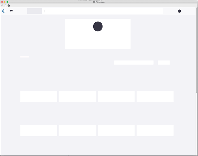

3D Warehouse and Extension Manager window open but only partially display in Sketchup Pro. There is no text or images. I can access these ok via a web browser but not in app.

Thanks, I’ve done that and I’ll see how it goes. I found the problem seemed to be related to the large size of my model (many components, far from origin etc), which persisted even when working on something small. But 3D and Extension Warehouses are working now.
