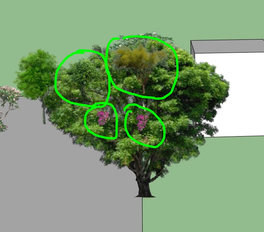

When exporting the scene as a JPEG image, the trees positioned behind the large front tree (circled in green) appear as if they are floating in the air.
Does anyone have a smart solution to correct this?

Where are the axes of those trees?
I have checked, all are centred to the components
Solution found, it’s the setting the “Transparency quality” to “Nicer” in the Styles>Edit>Face Settings
