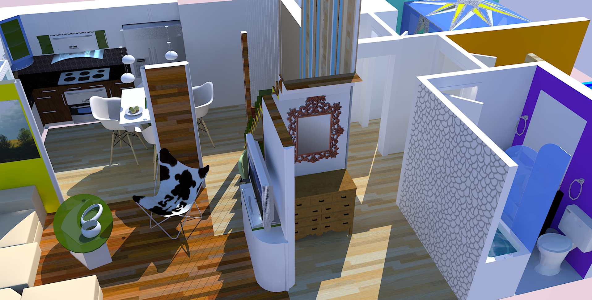

I like the Revit rendering machine that I find MY faster than the Visualizer for Sketchup that can take a whole night for a render that Revit will do in 2-4hrs max (unfortunately my PC can’t do the HIGH setting) So I have been working on Kerkythea that can do fast and not use so much power. But still have big issues I can’t get the sun to shine as I want it on projects that don’t have their own lights
Here is a basement suits I made
But most others (that I uploaded a few weeks ago to JIM are like in the dark) I put the pacific time september 3Pm but still it comes out very dark around
