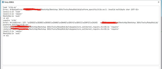

I am a developer of plugins and I am using Sketchup2024 Simplified Chinese version. Why can’t I load zlib?
Something to do with the username path and not being valid UTF-8?
No,my Windows username is English
I am running on an English system, with SketchUp set to “en-US” localization and can load it:

Can you load any other *.so files, like openssl, psych, josn, etc?
Many people are running Windows 11 or 10, I don’t recall what sort of encoding issues older Windows versions have…
Depending on whether you can load other *.so files, would you be willing to try a stand-alone Ruby (similar to SketchUp’s Ruby) to see if you could load zlib, etc?
SU Ruby jumped from 2.7 to 3.2, there’s a lot changes, and I would think that encoding issues would decrease with later versions…
